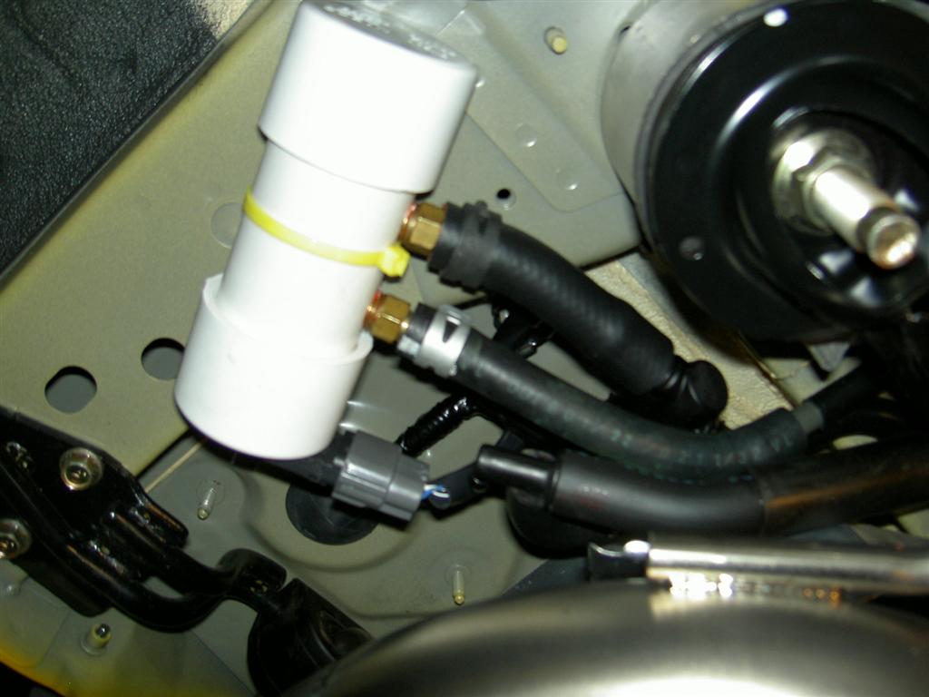

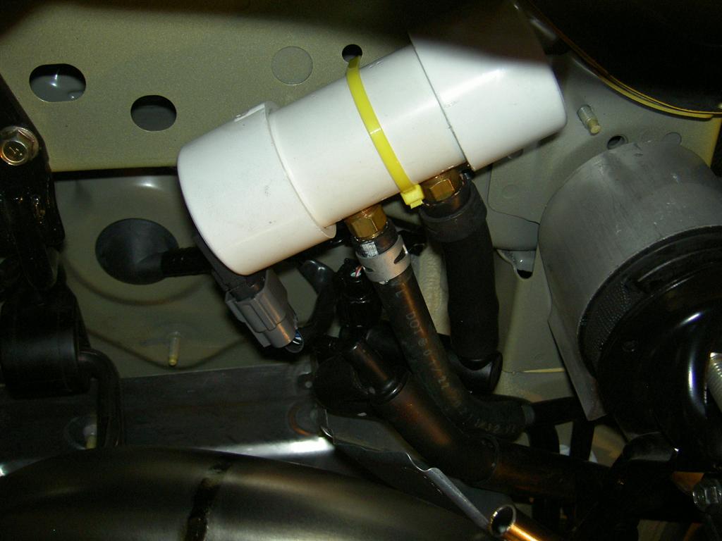

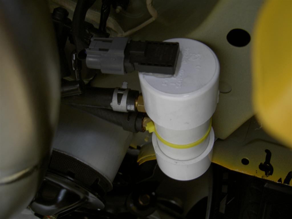

Old Nov 10, 2006 | 12:02 AM
undrgnd's Avatar
undrgnd
Posts: 1,203
From: MD
Originally Posted by MustGoFastR
Yeah, I saw a DIY thread about a week ago where a guy replaced the canister altogether with a little PVC contraption; pretty slick job. Try to search it up.
The 1 1/2" PVC cylinder takes up almost no space, is much lighter and does not throw a CEL. It's definitely a DIY, and I never wrote up any instructions, but the hoses are routed just like the originals. Take out the cannister and stare at it a while next to the cylinder, you can figure it out.
