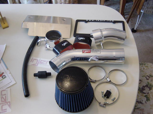

I finally got the Injen intake that I've wanted all along (polished tube w/black tubes and filter). Below is my opinion:
Aesthetics: Looks great, very happy with it.
Installation: The question everybody asks, do I need to take off the bumper to install? Not necessarily, but taking it off (or at least taking one side off which will give you room to work from the bottom) makes it much easier. If you do not want to take your bumper off, I would recommend lifting the car as this will allow you the room needed to reach in and remove the splash guard located right behind the grill. This splash guard is not easy to take off if you do not have any leverage. The most important thing to have is the right tools. For example, I was able to use a ratched with an extension to remove the left bolt from the manifold to install the heat shield but could not get the right bolt off with this tool. I used a hand wrench which has a flexible ratchet action on one end and this is what made it easy for me to remove this bolt. Also, in order to remove the bumper without taking off the wheels you will need a stubby philips screwdriver to remove the screw which holds the panel attached to the bumper. Lastly, in order to squeeze the silicone tube through the air vent and down the bumper I used a spray lubricant so that it would slide easily (I was struggling initially when I was trying to slide it without out any lubrication). Other than this, the install is straightforward. It took me about 4 hours to do it as I did it by myself but I believe I could do it now in 1-2 hours. It helps to have someone there even if it's just to hold a flashlight (if you do inside a garage).
Sound: At idle there isn't much of a difference from the stock sound. It does come to life when you get over 4K RPM. It is not loud but does sound more aggressive than stock and I can feel the air rushing in.
Performance: I can feel a little more power over the stock setup but only when over 4K RPM. It is not a dramatic difference but it does feel a bit more powerful. Obviously, a butt dyno is not as good as a true dyno but, again, this is just what I feel.
Overall Satisfaction: Very pleased. I love the look and the sound is what I was looking for. It's quiet when cruising but comes to life when I want to play and does seem to pull more than the stock setup.
Below are some pics.
Attached Thumbnails Installed polished Injen CAI w/black hoses and filter-injen6.jpg

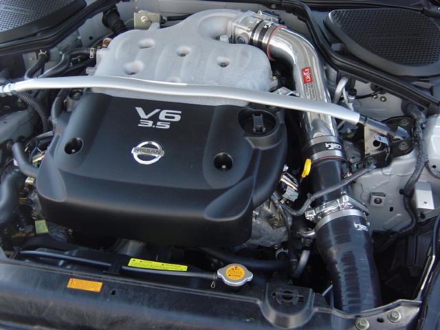

Side View:
Attached Thumbnails Installed polished Injen CAI w/black hoses and filter-injen1.jpg

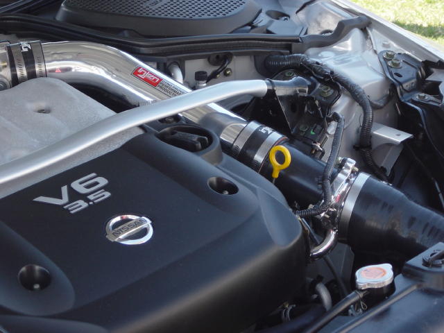

Other side view:
Attached Thumbnails Installed polished Injen CAI w/black hoses and filter-injen2.jpg

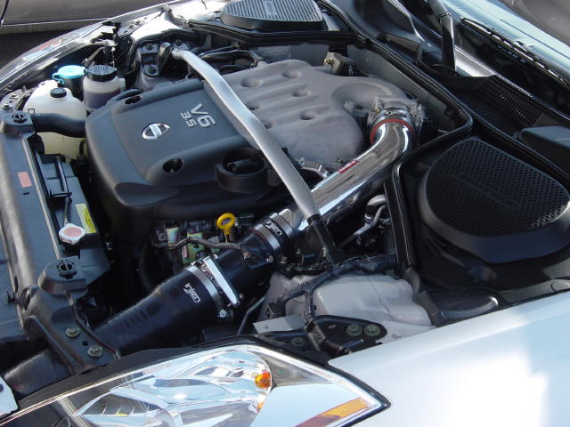

Top View:
Attached Thumbnails Installed polished Injen CAI w/black hoses and filter-injen3.jpg

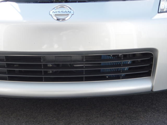

Air filter behind grill view:
Attached Thumbnails Installed polished Injen CAI w/black hoses and filter-injen5.jpg

looking at where u filter is... if it rains... aren't you goin to be in some deep dookie? or do you have the by pass valve thingy?
Old Apr 6, 2003 | 07:16 PM
vics350's Avatar
vics350
Posts: 2,013
From: Connecticut
Injen does not offer a bypass valve. There have been other members that have posted driving their car with this system in pouring rain and did not have a problem. The only damage you can have is if the filter is submerged in water (ie. a large puddle). Hopefully this won't happen to me as my car only comes on weekends (if the weather is nice).
