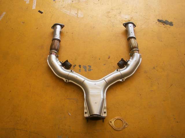

From: Atlanta
We took it off my car and it is a little different. the Y-pipe has little plastic weights on them, I guess to reduce vibration. The headers are different for the new motor as are the cats. The flange in between these two is at a different angle and has an interior seal that is different. The rear muffler is minus the air shield on the muffler but is pretty much the same as far as mounting points.
Hope that helps. I have some pics somewhere. I will try to post them later.
EDIT: Found y-pipe the rest of the pics I don't have at the moment.
J

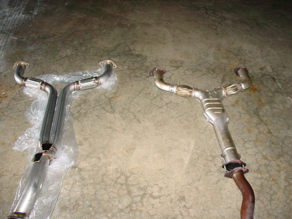

yes, for comparison here's the y-pipe out of my '06, along with the nismo on the left..
