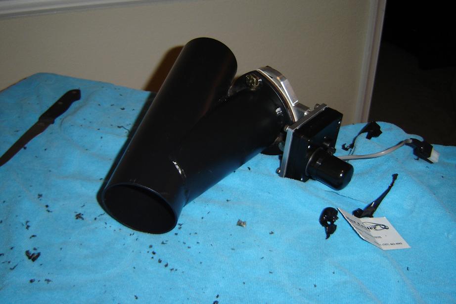

So this past week i got my new 3" DMH electronic exhaust cutouts from DMHperformance.com. And i have to say, for a $200.00 mod this thing is really cool!!! Basically it's a length of pipe (3" due to where i put mine, and i have the Nismo catback) with a piece of pipe coming out the side to "dump" the exhaust and bypass the muffler. And instead of having three wingnuts and a flange to remove, you just push a button and it opens up a tightly sealed butterfly valve and bypasses your exhaust!! And the great part is that you can vary how loud your exhaust is when ever you want!
There has been talk of raspiness and loss of backpressure before, but those people had bought two of the smaller ones and put them just after their cats. To hopefully overcome both i installed mine just before the last bend before the muffler, so the resonator would still offer some muffling and hold in some backpressure. And it worked!!!! It sounds incredible!!!! Imagine your stock exhaust note that we all love, amplified 4 times!!! And you can hear the cam lope nicely when excelerating now!!! (Only car i can think to compare it to is the Volkwagon R32s, which have a real clean rumble when excelerating) I have felt no loss of power, if anything i have gained a bit at higher RPMs. And since it's so close to the muffler, there is zero rasp!!!

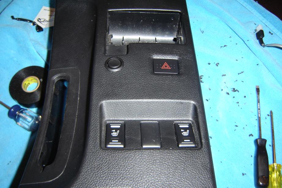

Just went to a trusted local muffler shop, showed them where i wanted it, and an hour later and $45 lighter it was in!! I installed the rocker switch myself the night before. It's a pigtailed wiring harness VERY professionaly made. One 12V switched source, and one to ground. Then just plug and play the button and the dump. I ran the cable through my shifter boot. (Flame on) And installed the button to the left of the hazard switch. Switch is very high quality. And it looks like it should be there.
