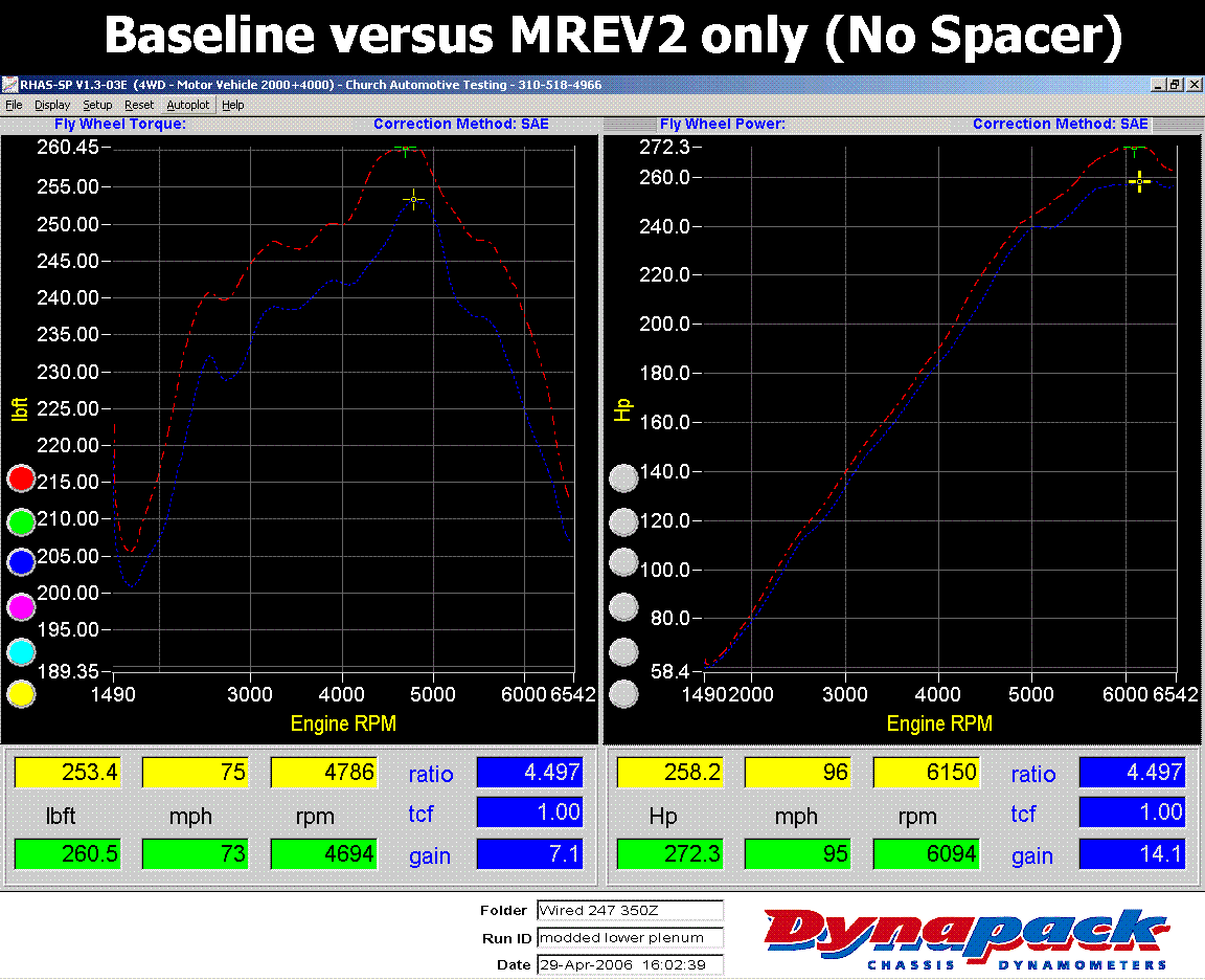

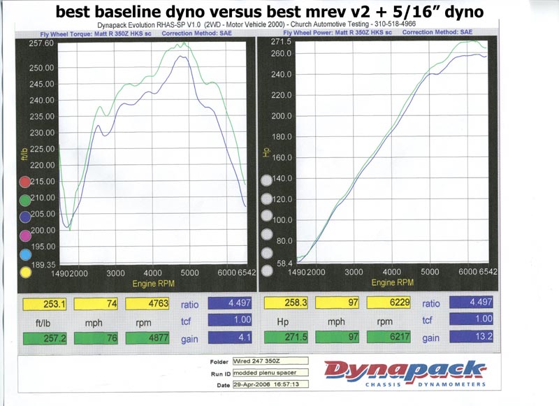

Not to start a debate but there is already dyno sheets avaiable on this forum that show the mrev giving nice gains on a non revup motor by itself. I will try searching to find them and post if I find them.
Keep me posted on the dyno Philly I'm confident they will prove me right.
Jim I got crawfords headers and they seem to do well.
here are the dynos compare for yourself...heres the link to the thread
https://my350z.com/forum/showthread....ghlight=mrev+2
