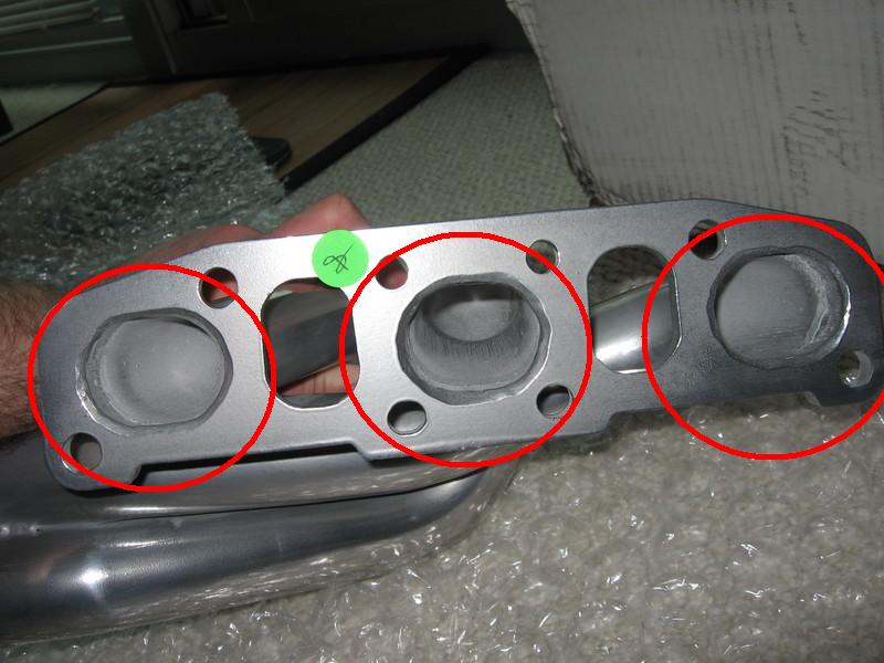

those are pretty. Nismo are quality pieces. One thing though, you aren't really going to be happy with performance of headers. But they are still adding to the N/A hp/tq.

As a note; If you don't coat or wrap your headers, you might want to heat wrap/ heat shield your brake lines, fuel line, AC line, etc.... The headers run pretty close to those areas.

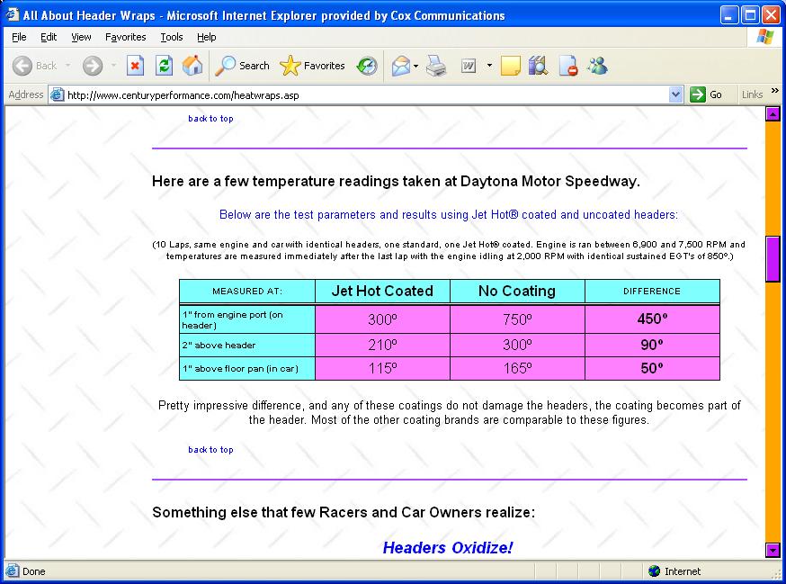

Ive heard wrapping headers with heat wrap can actually promote cracking after pronlonged use b/c it can trap moisture and heat b/w the wrap and the headers. Dunno if that's true or not... Headers are such a pita to install that for me, id rather play it safe than sorry--its something you really only want to do once.
http://www.centuryperformance.com/heatwraps.asp
Taken from the above link--believe it or not--one person's opinion:
"Why Header Wraps Suck ... and Why Header Coatings Are Recommended"
Many times I've been asked about, or have commented on the use of header wraps. This issue is a real pet peeve of mine. Good or bad about a product I'll give my opinion based upon direct use and fact.
THE FACTS:
Header wraps are designed to keep the heat in the header to improve scavenging of the cylinders. Keeping the heat in the header allows the exhaust speed to remain high. (the right idea)
There are no header manufacturers that I know of that will warranty their headers if any header wraps are installed on their products.
In most cases the header wrap damages the headers beyond repair. (I will explain below)
If you run a lean mixture, you "may" see a slim performance gain using header wraps. A rich mixture may show slim to absolutely NO gain in performance.
If you do not mind replacing your headers and header gaskets regularly, and you like that ugly look of a wrapped header, go ahead and use the heat wrap.
BACKGROUND INFORMATION:
In the past, almost all NASCAR and other racing engine builders used the header wraps for the added power gains. But, after having to replace the headers after each race due to the wrap being about the only thing holding the header together, they do not promote the practice any longer! They now utilize the thermal coatings that are chemically and electrically applied to the headers. Those include Airborn, Jet Hot, HPC, and others.
Imagine having to replace a $1200.00 plus set of headers after each race weekend! Few but the most financially well-off race teams can afford to do this. But, it is also in the downtime for remaking a custom set of headers. Most custom header makers do not have copies readily available.
I believe that the wraps are good to protect various items from heat, but not to hold the heat in the header. For example: you can use the wrapping for the protection of fuel and oil lines, wiring, etc.
Cool air needs to be around the header, and insulating it with a wrap to hold exhaust heat in makes the header material temperatures near molten. When you wrap the header you trap the heat in the header, but also in the material that needs to breathe to dissipate heat for it's own survival.
Engineers, Metallurgists, and other experts out there will state that there is no way that the material can fail because it can withstand, and it was designed to withstand, the internal temperatures of exhaust gases. TRUE! But, when the header is not allowed to cool so as to dissipate those extreme temperatures that the wrap is controlling, you have now developed a heat absorption that compares to thermal friction which will will continue to gain in temperature beyond the normal exhaust gas temperatures (EGT's). This is the same as with most any insulation.
Try this experiment ... launder a load of bath towels and then dry them. Immediately pull them out of the dryer and just toss them in a snug pile on your bed. Now leave them there for a day and then open them. You will find that there is still a considerable amount of heat left in the center towels. This heat, even though the outer towels and bed are normal room temperature have been able to contain their heat. This is a simple thermal insulation test, but with your headers you have an internal heat supply coming from the engine. The heat on the outside portion of the header material is trapped between the warp and the header and will continue to fatigue the header. This build of heat is amplified by the wrap. Towels do not need to breathe, header material does.
The EGTs stay the same but the properties of the header material changes in a way of amplifying the temperatures because of the insulation. This action goes against normal laws of thermal dynamics, but this effect is fact, and you have to pull the ears off most engineers before they believe you. This is the trouble with plenty of education, but NO "common sense"!
http://www.nissanperformancemag.com/august04/ask_sarah/
taken from the above link:
I have heard it said that in addition to decreasing the underhood temperature, header wrap also increases the flow rate of exhaust gases. If this is true, could you please describe the mechanism that accomplishes this?
Barron Keith
Golden, CO
The idea behind header wrap is the heat will stay in the header improving the scavenging effect of the cylinders. Hotter exhaust gases flow more easily. The problem is it works so well at trapping the heat in the header, it doesn't allow the heat to dissipate and temps will increase beyond the exhaust gas temperatures (EGT's) the engine normally sees. This heating and cooling causes the header to fatigue and will most likely end up damaged, increasing your chances of buying a new one! Nascar and other racing teams used to use heat wrap until they realized any extra performance they may have seen wasn't worth replacing the header after each race. Heat wrap is more meant to protect wiring, fuel and oil lines, fans, etc. from heat.

Ohhh, not peddling JotHot, huh?? Have another look at the attachment below from your link...
Here's another link explaining why header wrap is just fine. This link is not trying to sell anything - it just explains what header wrap is and what it does. Have a nice day yourself.

ummm, in no way was my link peddling jet-hot--none of those links were associated with jet-hot. They were 3rd party opinions--so yes they are mored credible imo than a header wrap manufacturer. Did I link jet-hot.com? No. You are mistaken.:
