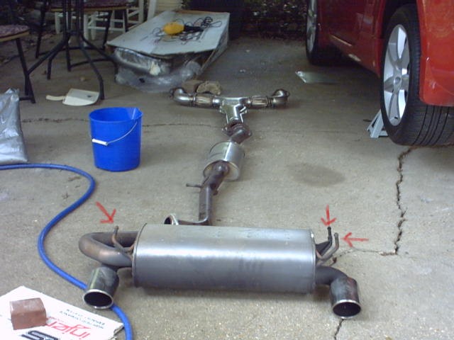

Now you should have enough play in the system to remove the factory y-pipe and the connecting pipe containing the factory resonator.
Next remove the stock muffler. This was the most difficult part of the install for me. The muffler hangs by 3 rubber exhaust hangers. You can remove the single hanger toward the front of the car by removing the bolt holding the hanger in place. You will have to move this hanger to a different position to hang the passenger side SES pipe (pics to follow). The two hangers in the rear are a different story. They are extremely difficlult to remove. Do what you have to do, but realize that if you cut them you cannot buy these at autozone. They are specific to the 350z and must be ordered from nissan.
Here's where they're located:
Attached Thumbnails Injen exhaust installation instructions and pics.-stock-exhaust-on-ground.jpg

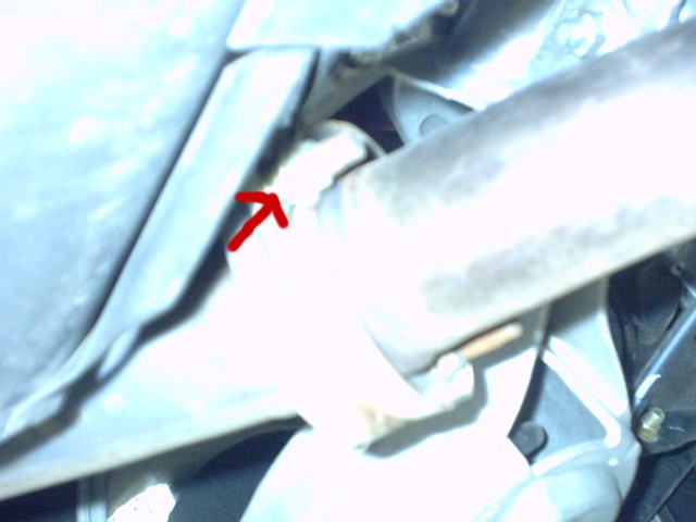

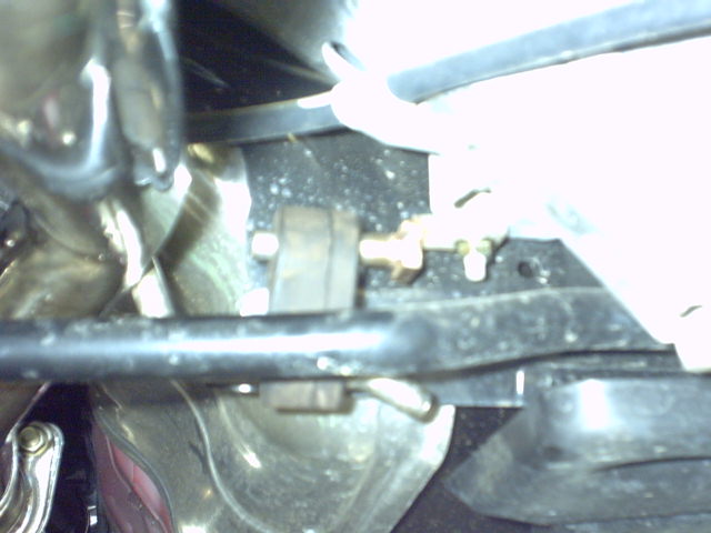

Now you can start installing your new exhaust. Start by placing stock hanger you removed in the last step in the new position right above the sway bar on the passenger side using the bolt and prong provided by injen in your kit with a 12mm wrench.
Attached Thumbnails Injen exhaust installation instructions and pics.-relocated-hanger.jpg

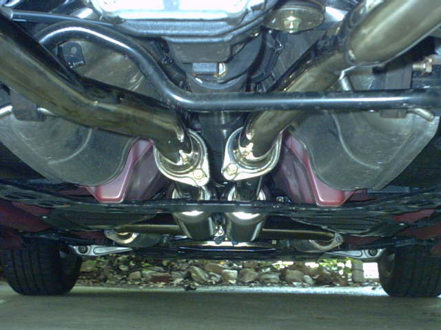

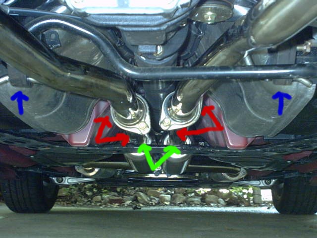

Now just start hanging the new exhaust components from the cats and work your way back. The flange connections marked by the red arrows can be used to adjust the system because you want 6-10 mm space between the brace and the pipe (green arrows). Also allow 6-10 mm distance between the resonators. The blue arrows just signify the two proximal exhaust hangers.

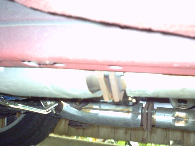

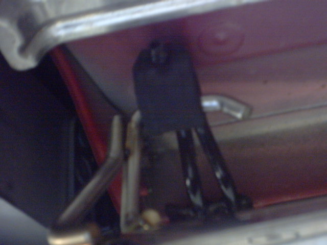

Hang the two cans by the rear exhaust hangers. To make the job easier I attached the hanger to the SES first and then just slid it over the factory attachment.
Attached Thumbnails Injen exhaust installation instructions and pics.-rear-hanger.jpg

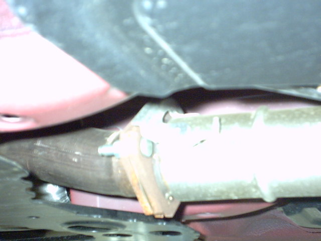

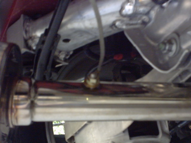

Finally, attach the ground wire and give your exhaust a good wipe down. If it gets hot all the grease and fingerprint will be very difficult to get off.
Attached Thumbnails Injen exhaust installation instructions and pics.-ground.jpg

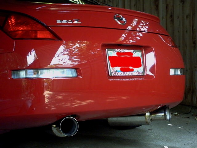

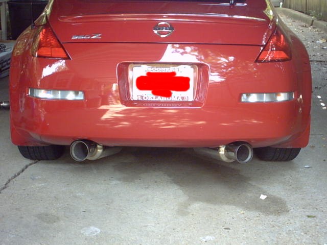

And now for some pics of the completed install
Attached Thumbnails Injen exhaust installation instructions and pics.-ses-complete.jpg

I'll have some sound clips for you all as soon as my buddy gets here with his lap top.
Attached Thumbnails Injen exhaust installation instructions and pics.-ses-complete-side.jpg

Does the right one come out at a different angle than the left? Or is it the angle of the camera? If you drive with the windows up, does it have an irritable drone? I just ordered yesterday, and hoping I made the right decision. Thanks
They come out at the same angles...i mean, there may be a couple mm difference but it's hard to tell. At highway speed there is not a drone.
