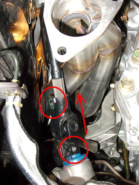

The shaft itself doesn't move. It's the coupling that moves. The coupling should just slip off the spline (going in an upward motion). But mark it first with whiteout or something, so you can align it when you put the u-joint back in.
Undo these two bolts (I think they're 12mm), then slip the entire coupling up and off the steering column.

Is this the knuckle you are talking about? Spray with some penetrating fluid. Remove the bolts completely.
Maybe my memory is alittle hazy. My shaft (steering ;p) moved, you could push it up a few inches and out of the way entirely.
