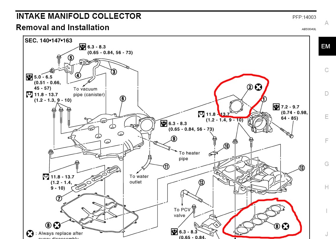

Does any one know the part #'s for #2 (throttle body gasket) and #8 (lower plenum gasket) as seen in this pic?

http://www.courtesyparts.com/betasit...5_716_727.html

thanks alot, for some reason my parts # sheet doesnt have any manifold related PN!

oh ya, its for a G35c but they are the same things right?
Should be fine.
I don't remember having a gasket on my throttle when I put my throttle body spacer on though.
Unfortunately, the FSM doesn't have any part numbers.

ya i have another couple pages with PN and prices and shop hours to install on it for my G35. No intake/manifold #s though.
Of course Courtesy is out of stock on a other things that I need, so I might have to order from the local dealer. They are the biggest crooks around and it makes me not sleep at night thinking they are getting my busness. argh...

For future reference
Lower plenum gasket is : 14032-AM600
Throttle body gasket : 16175-AR000
