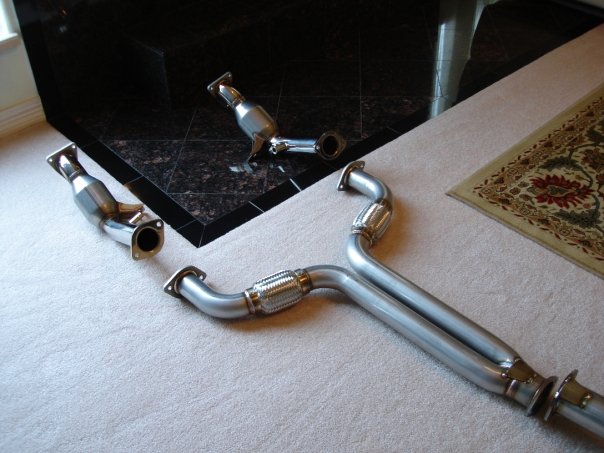

REALY ,in fact thats my next mod 5/6" Iso thearmal pleanum spacer ,about the gears no can do i`m A/M .
and about HKS i don`t want to lose the stock look ,if i didn`t get what i`m looking for with reset, tune and spacer i`ll go with nismo (they fix the cracking issue with some brakets in the joint of the Y pipe)
the pic is from gsingh350Z thread about his new nismo exhaust ,and the sound is so beautiful
