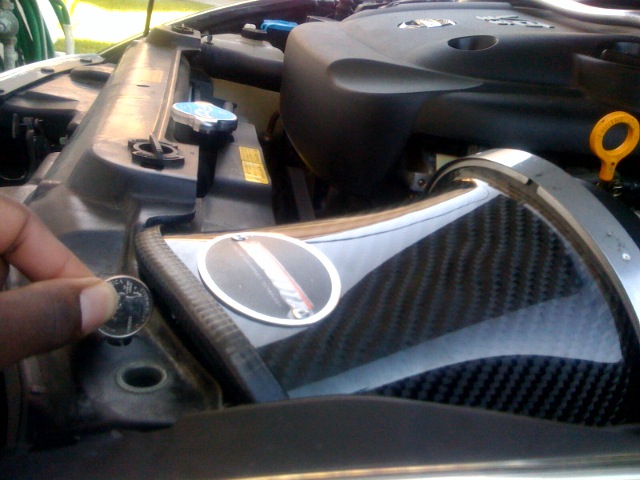

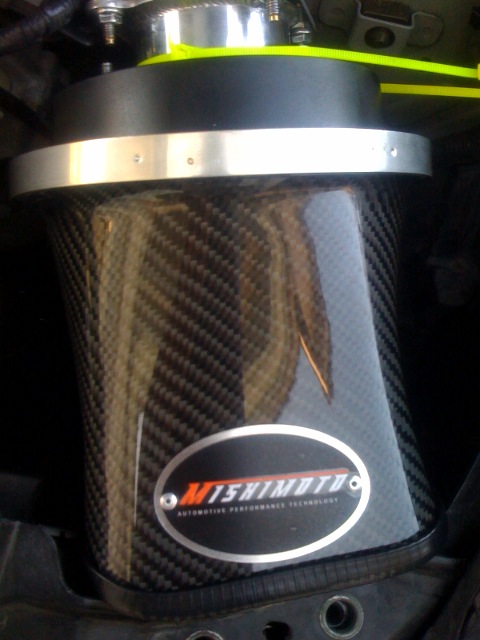

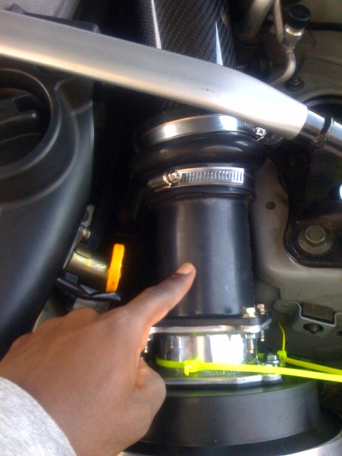

I hope I am not stealing his thunder but here are the pics he sent to me

BTW he said the zip tie was just temporary because he needed to go somewhere but it is attached properly now.

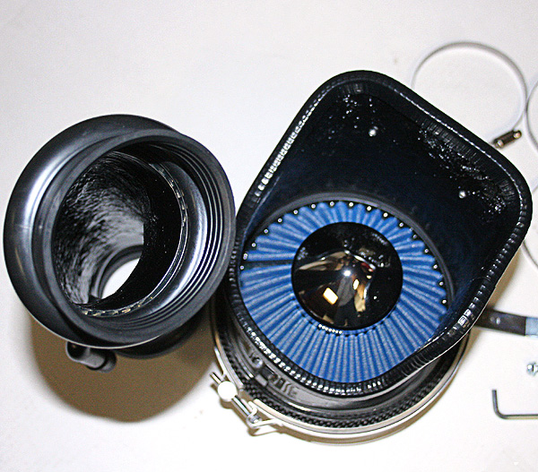

Soooooooo..... When the filter on this handy-dandy intake gets dirty, do you:
A) Get a new filter from somewhere
B) Clean the filter & oil it. And if so, how many times can it be cleaned and re-oiled before it starts falling apart?
Old Jul 21, 2008 | 05:19 PM
_ink's Avatar
_ink
Joined: Mar 2008
Posts: 379
From: Sydney, Australia
If you look at the picture you will notice that the filter is held in place with a large O-ring clamp.
The filter is cleanable as it is a 4 Layer Cotton & Aluminum Mesh High Flow Air Filter.
When the tine comes for replacing it, just get one that is the same diameter.

Thanks for posting pics. What's with that big metal cap blocking the center of the filter?? The Mishimoto filter surface area looks pretty small compared to others. And that metal cap ain't helping. It's only gonna flow halfway decently at the expense of not filtering very well. Not worth injesting sand and dust particles into the engine to get a small filter to flow well.

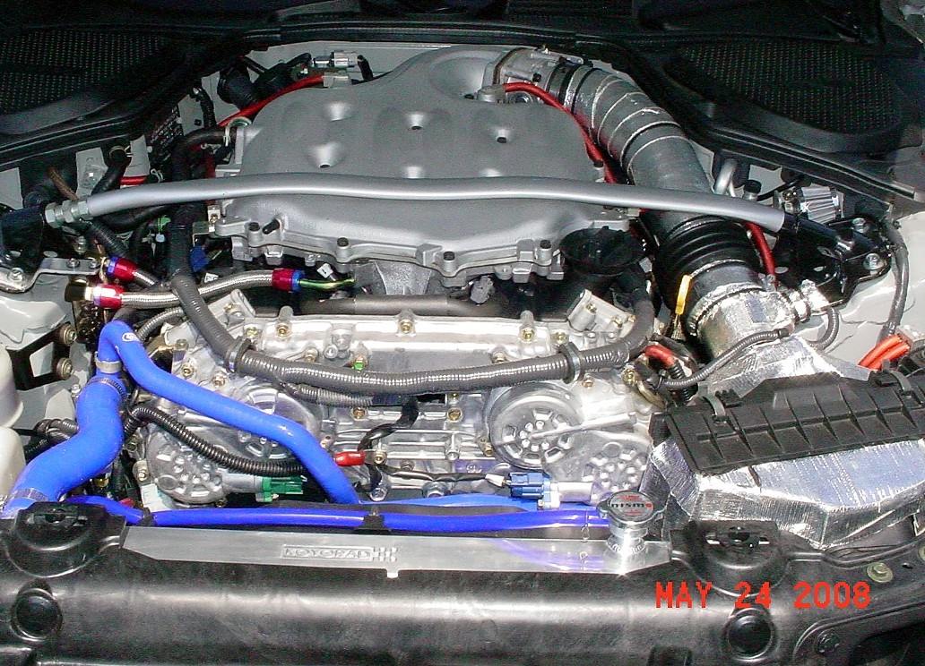

I think I'll stick with my 06 airbox and Amsoil drop in until I can afford a Gruppe-M.... I also heat shielded the entire length of my factory intake to help minimize heatsoak issues. Not as sexy as the Mishi, but effective.
I do like the look of the Mishimoto CF though!! If they could make something comparable to the Gruppe-M ($1000) at half the price, I'd be all over it.
