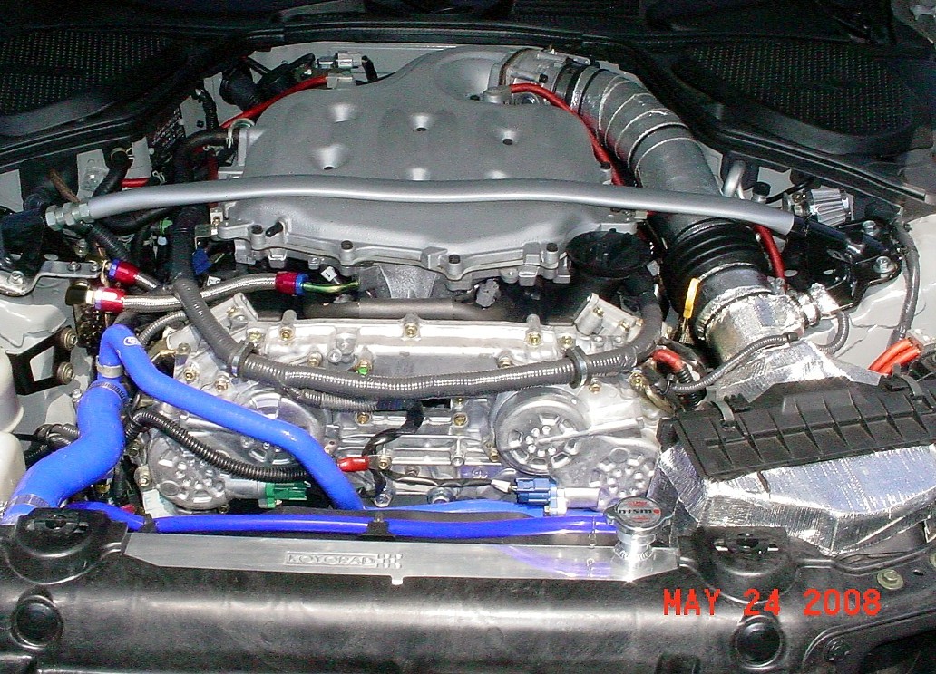

Have an 06 box in my 06. works well. I went the added route of heat-shielding the entire intake to help keep heatsoak to a minimum.
