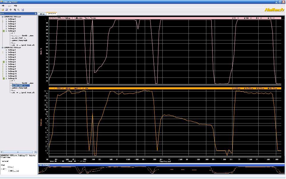

ok, so hal from Injected Performance helped me get setup here...sent me a base map for the Haltech that would let me plug it in and still use all the stock ECU settings...
This gave me access to the attached chart.
As you can see...the throttle position is reading correctly...0 to 100...but for whatever reason, on hard shifts...the injector fuel time is getting cut in half (roughly) until i let off and get back on it.
aka...no problem for tuning it out according to hal!!!!
I go next tuesday for my tune!!! giddyup!!!!
edit:
top graph = throttle position
bottom graph = injector fuel time
