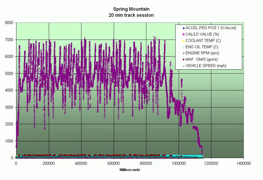

For a different comparison, consider the effect of MREV2 in Road Course racing.
The difference here is even larger!
Look at the attached Cipher data logging below. It is a logging of engine parameters while racing at the Spring Mountain race track in NV.
We can ignore the last cool down lap so look particularly at the RPM's between ~20K to 80K ms and make a visual guess at what the average RPM is...
Another thing to consider is that while the average RPM tells us a lot, what we care about more is RPM when the pedal is slammed to the floor WOT and using all the available power. Partial throttle is irrelevant because either plenum can make the same power at partial throttle.
This data was entered into Excel for detailed analysis. The actual time weighted, WOT, RPM average as analysed in excel is 5630.16 RPM.
5630 RPM is the most used, WOT, RPM while road course racing. And yes, this value will vary from track to track and from driver to driver, but it won't vary that much.
So now that we know the engine spends more time at WOT @ ~5630 RPM while road course racing, take a look at the dyno plot again.
5630 RPM is right smack in the middle of area "B" of the MREV2 dyno plot.
So on the road course, the MREV2 is roughly 10+HP superior to the stock revup lower collector. ...Even if its JT's NA build.
On the street the MREV2 is faster.
On the drag strip the MREV2 is faster.
On the road course the MREV2 is faster.
If you don't agree, please elaborate.

If you would like to see more of the track data or different parts of it just let me know. I'll re-plot and highlight any part of it and post it for you.

Now, try it again with the a 8000rpm redline, and Revup making peak power at 7200rpm. That is, afterall how the car is set up.
