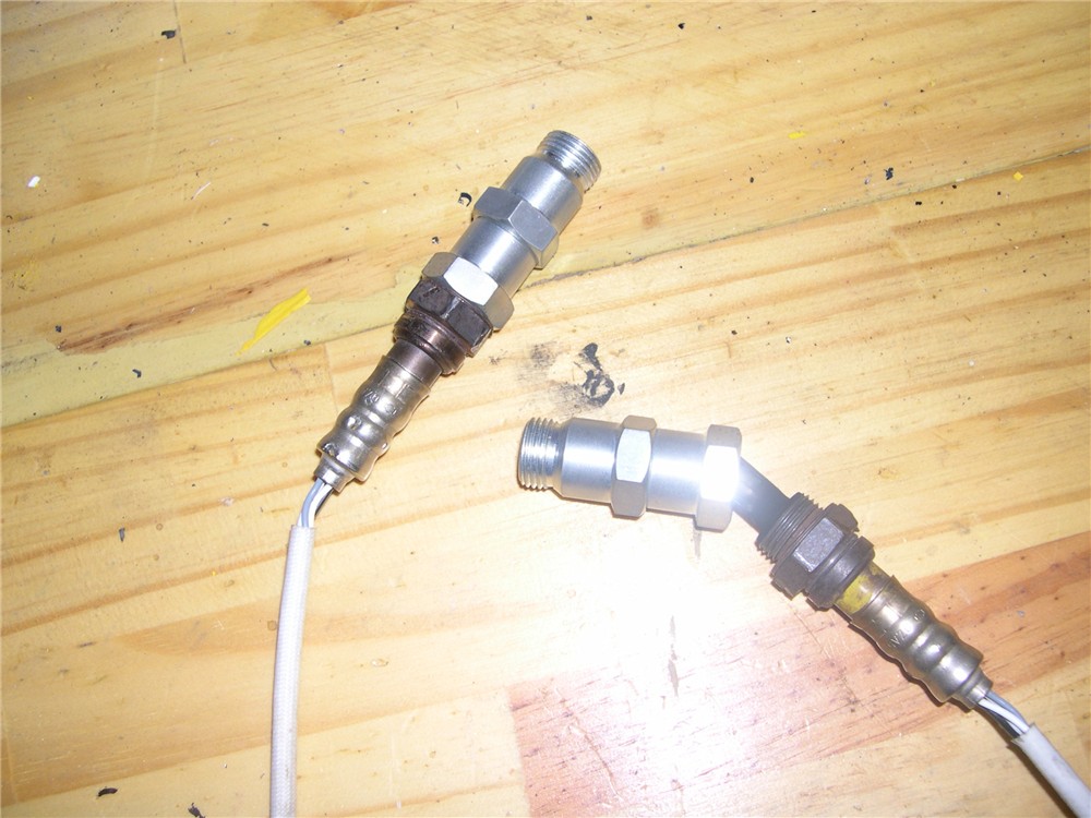

I've been running non-foulers for almost 1 1/2 years. Works great for me. I do get a random 02 code like every six to nine months, but I just clear it after confirming it's 02 related. Codes are just part of life when you start modding. Get a cheap scanner or Cipher to make your life easier. Oh, and like davidv suggested, you'll be well served to get an 02 socket as well. I got mine at Advanced Auto for like $12 bucks.
There's a thread in the DIY section on how to make your own Non-foulers.
Attached Thumbnails Non-fouler questions.-erins.jpg   Non-fouler questions.-non-fouler-20022-1-.jpg
