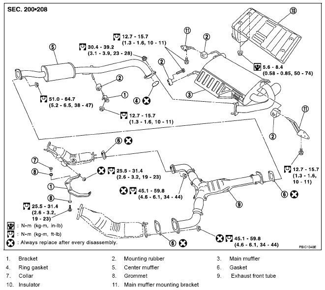

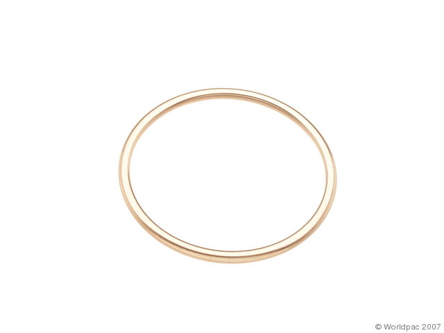

guys need help, while checking my stock exhaust i found out the i`v lost the ring gasket :
number for in this manual :
can i replace it with a normal gasket just like the one between the Y-pipe and the down pipe ?? or there will be leak !!??

I've done that, and it works most of the time, but its better to use the ring.

go check out at local muffler shop.
