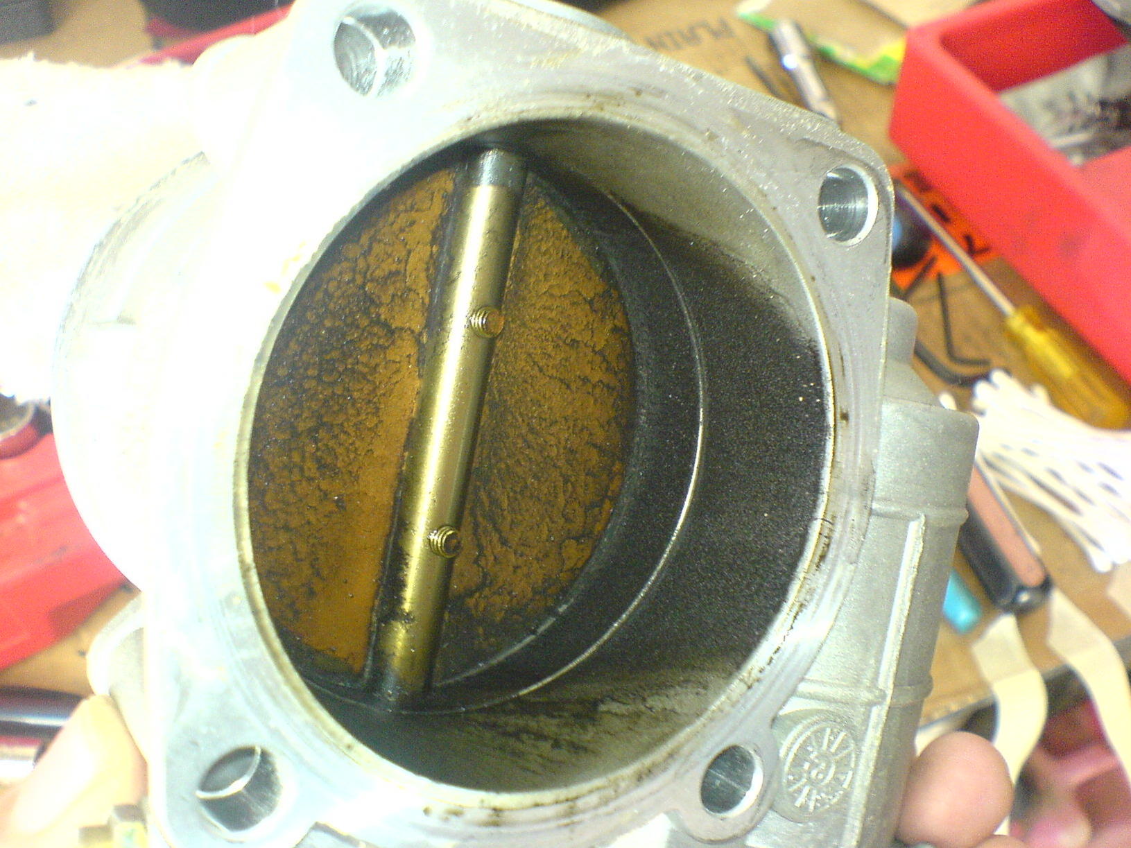

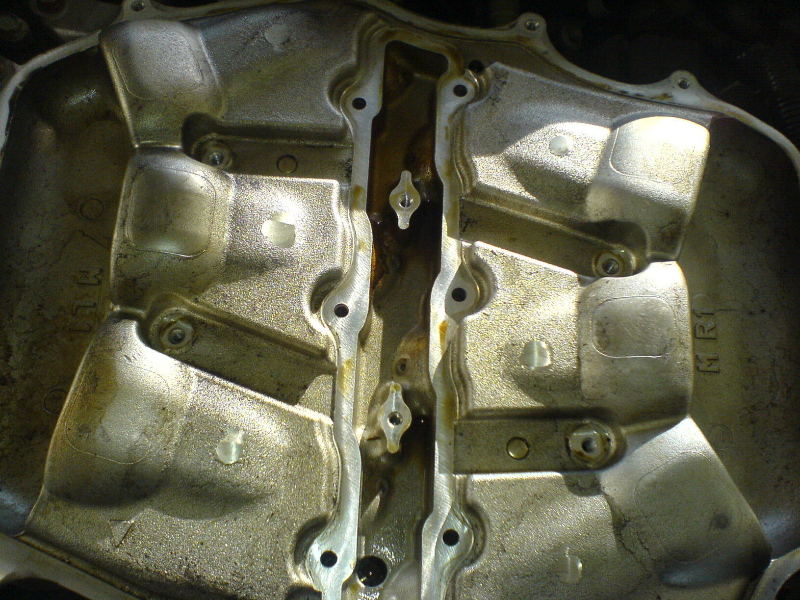

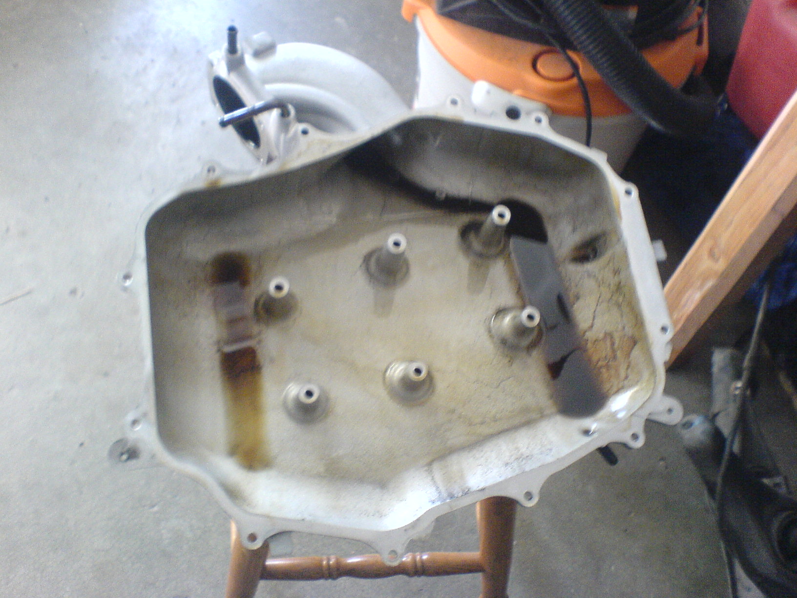

ok no didn’t miss with the MAF sensor….but I did disconnect it when I was checking for any leaks in the hoses and none but I did reconnect the MAF sensor back in place and the old gasket back a place but DIDNT use the copper spray…the prior owner of the car had a injen cold air intake lmao suck up hella gunk build up over time going to post the pic of the dirt that **** did to the manifold build up like not changing the spark plugs, collocate brown oil , oil filter, and I think it still had the original belts from the factory hella cracking and **** barely notice the Nissan imprint.. what I have listed is what I have had done to the car in two week of own my z period to working a fulltime shift every day only had 3 days off using that time to clean and maintaining the to car up to date and that including the xmas I was working on the car that...lol

ok i cleaned the manifold,throttle body, MAF, change the gaskets upper intake gasket brand new oem, and throttle body gasket brand new oem, but the ses light keeps caming ON i did the 3 relearns then drove for 30min around town and the light came back on still cant figure the problem so i got a friend to get the code read and got P0507 thinking its a vaccum leak so i spray around the manifold with carb cleaner and double check the hose for cracks but nothing everything connected....need help my car is stock 350z

P0507 Idle Speed Control System
Its probably throttlebody calibration.
Do the reset procedure linked above. If that doesn't fix it, you may have damaged your throttlebody during the cleaning process. ...they are very sensitive.
