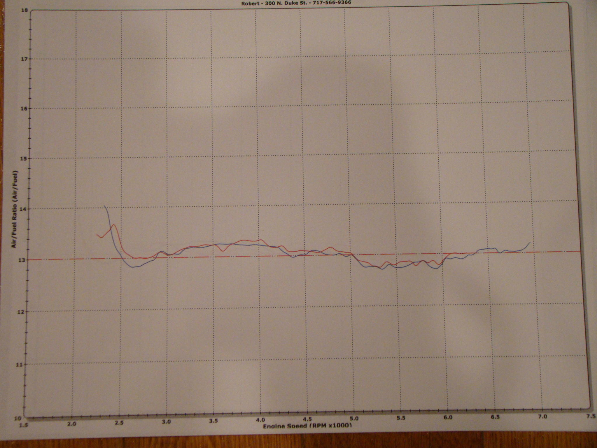

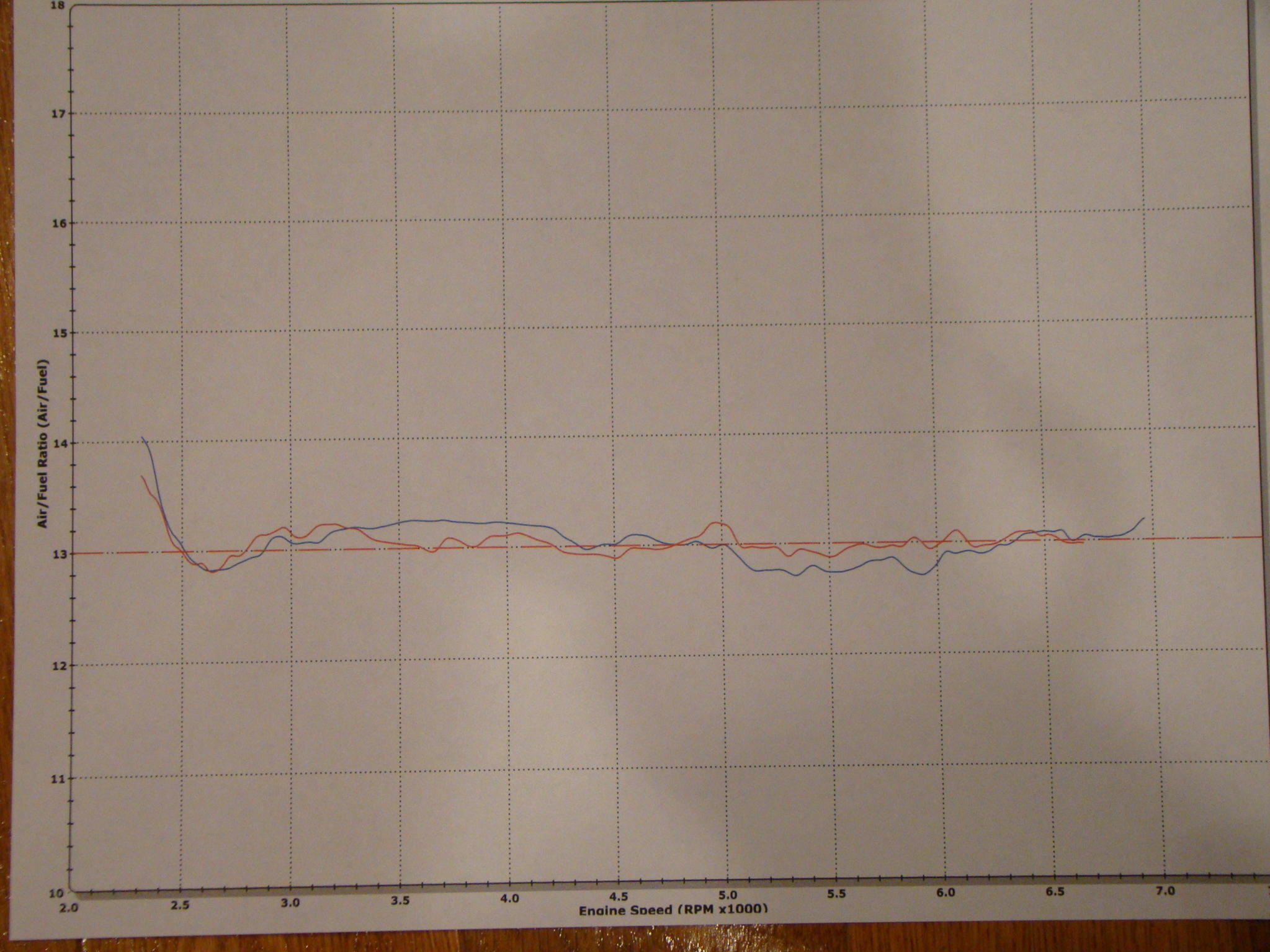

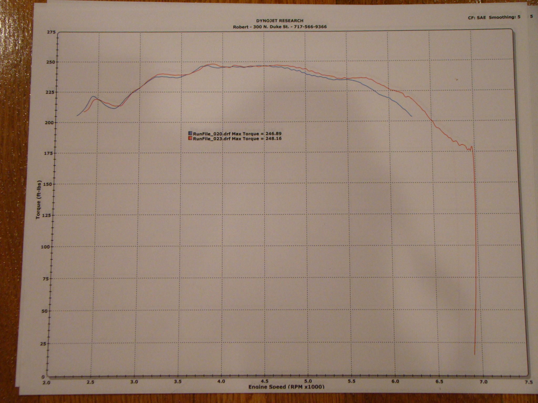

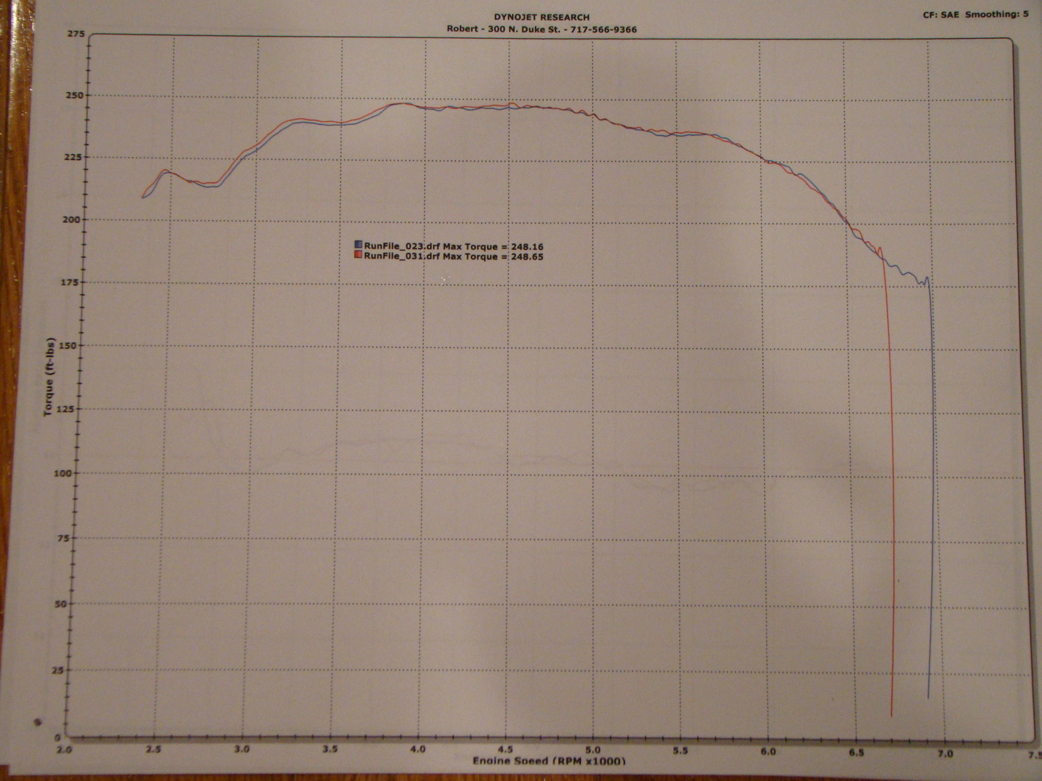

Here are the torque and AFR graphs I promised. The first of each is the modified vs modified + TB + Extrude Hone. The second of each is the modified + TB + Extrude Hone vs the same + the 3.5" intake tube.
Bob

So after all those mods and money spent u have 260hp?

Originally Posted by gabe3d
How was your AFR and MAF prior to tuning the car with the TB+Honed Plenum? Did those change at all below 4500 rpm? I'm assuming that most or all of the changes were observed at higher rpms with better airflow. Did you tune the car yourself? Thanks.
They were off a little below 4500 and off significantly above 5500. I relied on some help from the dyno/tuner guy. I had asked for his help tuning the car when we switched to the 3.5" tube. I was told ahead of time this would pose some interesting tuning challenges. The TB and Extrude Hone tuning I could have easily done myself.
Bob

Originally Posted by 2004Black350z
Looks to me like there is still room in the tune for more power. Fuel curve leaves some to be desired, and I don't know how much timing he is using. 261 is reasonable.
Yes. I am more interested in the difference from stock since some dynos read higher or lower than others. On this dyno stock rolled in at 220.
Bob
Old Jun 5, 2009 | 06:08 AM
bluezee's Avatar
bluezee
Posts: 122
From: Harrisburg, Pa
Any suggestions on tuning? Fuel curve is somewhere between 12.8 - 13.2 across the board with the AFR corrections data logged from Cipher +/- 4%. Always open to suggestions, especially if it brings me more power.
Sorry for the edit. Timing is the base timing map that Uprev originally provided for 92 octane fuel. I have a more aggressive timing curve for the 100 octane race gas.
Bob

Old Jun 5, 2009 | 06:19 AM
rcdash's Avatar
rcdash
Joined: Jul 2005
Posts: 6,474
Likes: 65
From: Chapel Hill, NC
The AFR looks perfect for NA. Timing and intake cam timing could be adjusted but no way to know unless you get it on the dyno with someone that really knows Osiris. Dave at Function Tuned I think may be able to help but I don't know how much he'd be able to improve upon it. I think the torque curve looks excellent for a DE motor already.
You could ask UpRev for an e-Tune that is a little more aggressive with timing and see if it helps. If it doesn't, I wouldn't run it as it would just be bringing you closer to the knock threshold.
Really nicely documented project - kudos!
Thanks for the kind words. Cam timing is up next. I will try to extend the rpm range of the torque curve by tweaking the cam timing.

Old Jun 5, 2009 | 09:13 AM
03threefiftyz's Avatar
03threefiftyz
Posts: 9,848
Likes: 118
From: Frederick, MD
My mistake I was looking at the blue line. The red (new) line looks fine. Your gains are truely excellent for the mods you have. I would also recommend Dave at Function Tuned.....he seems to find power that others don't. I am almost 100% certain that the uprev reflash is sent with stock timing. As stated above it is impossible to accurately advance timing (without potential issues) without the car on a dyno. What were the results of when you tuned your car with extra timing at 100?
