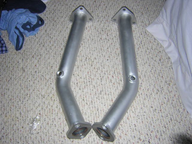

As some of you may have seen, I recieved and installed my test pipes today.
Here's some information:
The pipes are NOT crawford test pipes. I thought they were, as the person I bought them from told me they were. They turned out tobe custom piping someone made from this board.
The pipes were about 2.25" diameter, although I didn't measure them to be exact.
The pipes are NOT stainless steel, and are just coated.
Install:
It was fairly basic, just lifting the car, and removing the CAT's, and then putting the test pipes on. There was very few problems, some of which included it was hard to remove the cats since there wasn't a lot of room to pull it out, it was very tightly in, even with the bolts removed. Secondly, it was hard to reach the bolts to connect the test pipes to the headers, since they are pretty high into the engine, and at an angle. Total time of installation took roughly 2 hours. 1 hour 15minutes for the first CAT, and only 45mins for the second. This is just because after you do one, it's always easier doing the second one.
Review after installation:
Car is much louder. I can't stress that enough. When you start it up, it just roars.. the car sounds mean, and you can hear and feel the power just by starting it. When taking it out for a quick spin, you can definatly feel the "power". My butt dyno isn't very good, but I can honestly say the car does pull much harder, especially around 3,000-5,000 rpm range. It simply hauls a$$.
The sound.. can't really describe it. Doesn't sound stock, thats for sure. It doesn't sound like a japanesse car.. or domestic. It has a growl, but very intensified. This is the type of sound which some people might love, or hate. Personally, I love it. Soon as I turned it on, 3-4 friends commented by saying, "Jesus Christ, that sounds amazing!" if that helps at all.
Smell.... yes, there is a smell. Be prepared for that. You will NOT pass emissions with test pipes, most should know that, but if you didn't, now you do. The smell is there, but it's not HORRIBLE. You cannot smell it inside the car at all, only when exiting, or if you're on the outside of the car.
Smoke.. there was very little. Only when my friend punched it, I noticed a little bit of smoke, more of a greyish, not black. Don't worry about smoke with test pipes, it wasn't bad at all.
Bottom line:
If you're looking for more power, don't care about emissions much, and want a louder, deeper roar, test pipes are for you.
PS - I also have the full cold air intake, and exhaust, which contribute to the roar. I'm sure on a stock car, the roar would be much less.. (for those who don't have an exhaust on yet) And finally, I do have a slight leak I believe, as I do hear a whistle when I left off the throttle and coast.. I'll check that out on Wed. when I get my dyno, and sorry, I do NOT have a baseline
Any questions, please ask. Once again, here is a photo of the pipes I installed.
Attached Thumbnails Test Pipes Review - A must read if you plan on getting them!-picture-019.jpg

Those look like LSDunique's pipes. The leak is at the top of the H pipe.
RodH, 15/16" wrench will get O2's out and a 14MM wrench will get the cat bolt nut off.
I have the lsdunique pipes and they don't look like that at all.

Ricky, I have the same leak-like noise.
When I let off the throttle it sounds like a leak, but I doubt it is a leak since I don't hear it while revving up and while idling.
Also, the Borla H-pipe leak is obvious at idle and it goes after the cats, so if the cats were indeed leaking, then we would hear it even more during idle, but we don't. So I don't think it's a leak.
We made sure that everything was bolted up right, then we checked it out again after we heard the leak-like noise.
It might be normal with those pipes, however I have a slight metallic vibration noise. Do you have that?

I have a metal vibration noise at higher rpms, not at lower. I'm going to get my dyno done tomorrow with the pipes on.
Also before the dyno we're lifting the car to hopefully fix what sounds like a leak. Thanks guys!

Are you all sure it's not the resonance frequency of a different type of metal (that being the test pipe) that's causing the sound?
I had a very similar thing happen when I welded in a new SS resonator on my old car's exhaust... it sounded like a leak, but in fact, it was just a different type of metal and its resonance frequency.
