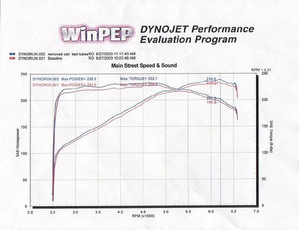

I got this put on this past saturday and dyno'd before (baseline) and after.
They didnt even move it off the dyno machine to install these so the car never really ran with the test pipes for more than like a minute so i think my ECU or A/F ratio didnt have time to adjust. My A/F was at like 12-13:1 (don't exactly remember) on the baseline run with the cats (which i hear is right on the money), and after the test pipes were installed the dyno sniffer showed 18:1 (is this safe to drive the car this lean?). The Dyno tech told me once the A/F ratio got correct i would gain a couple of extra HP. If anybody else dyno's this mod before and after please drive the car or reset the ecu before running second dyno.
Now for the Butt Dyno I DEFINETLY feel an increase (happened to be after ecu reset later that day) throughout the highter revs. This thing pulls harder for SURE!
I also installed a injen CAI and Insanes Gounding wires the same day (after dyno run) so that might also attribute to the increase in power shown on the butt dyno.
IMO this is a great mod and cheap for what you get if you dont mind the sound.
O yeah...it stinks too.. but the smell just reminds me of my motorcycle exhaust..its not so bad.
Dyno chart below
5th gear / 76 degrees / Dynojet
bone stock baseline / 2nd run test pipes
I also installed a injen CAI and Insanes Gounding wires the same day (after dyno run) so that might also attribute to the increase in power shown on the butt dyno.IMO this is a great mod and cheap for what you get if you dont mind the sound.
Dyno chart below
I am glad you liked the pipes, and those are good initial gains.
We are working on a version of pipes that will offer a more "mild" exhaust note, the noise between 3100 and 4000 has been pretty much the norm for test pipes.

it actually seems like it adds more torque all across the board then HP! I really want to dyno it again and see what my real gains are since the car has had time to adjust...
I will dyno again this saturday however its going to be after the Crawford *Bling* Plenum install.
