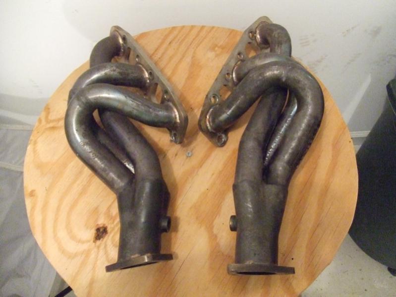

here's my set of authentic nismo headers for reference.
Attached Thumbnails is this authentic nismo r-tune header???-dscf0025.jpg   is this authentic nismo r-tune header???-dscf0026.jpg

Yeah.. see where yours are etched in I have the badge. I think that B&B makes them or made them and maybe they switched it up a little. Cause the model or part number matches up. I don't think that its a matter of being fake. Other than that they look pretty identical.

"The early generation NISMO headers (manufactured by B&B in AZ) had NISMO on the tag. The later NISMO headers (made by the former DC in CA) had the NISMO etching."
I got that from another forum guy can any confirm this cause it's crazy to think I could spend all that money on Nismo headers when all someone did is weld nismo tag on cheap ebay headers.

I would say that is true since the part number matches B&B's part number on their website. If you saw these in person you would know they are not cheap ebay headers by any means. If you look at them they are identical except for one having a badge welded vs the other have the word nismo etched in.

Out of curiousity and boredom I emailed B&B, here is the reply:
"From everything I see there these are the headers we produced. The tag in the first photo has our part number and build batch for identification purposes and if I remember correct was put out of site as they have the NISMO tag in the third photo visible. As for the two different part numbers the FPIM-0300 is our part number and 14002-RNZ35 is Nismo’s part number. It has been a while since we made any of these for them so I cannot say for sure who if anyone is making them now. I will say that if it is something NISMO is selling I am sure it is a quality part as I am aware of there quality standards and they will not just sell anything.
Mark Fowler
Technical Sales/Account MgrBilly Boat Performance Exhaust
623-581-7600 ext.18
mark@bbexhaust.com"

True, but since there's no way to find out what this header is made of or any specifications i wasn't sure. I hate to believe that it's fake that's why i'm still doing research and posted this thread. it sure doesn't look like cheap ebay header for sure!!! need more researching!!!

Apparently they aren't fake, just a different run of headers that Z1 has never sold before.
