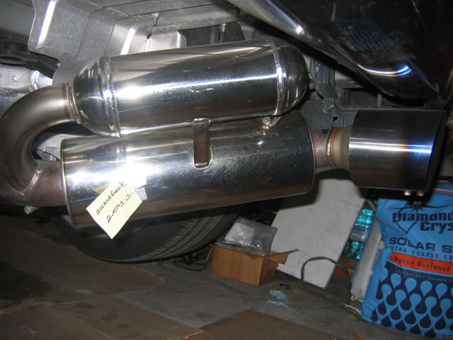

gary it wasn't directed towards you.. it was just in general. i'm just trying to show the community this what we're paying for from a "reputable" company.
SQ-I've had the ebay tips for over 10k miles now and there is no discoloration. the gauge thickness is much thinner than the HKS but i don't think that really matters as it is for looks anyways. as you can see in the pics it's still shiny and the tips are still bluish. They make great replacements. you can't beat 50 bucks vs 200 each from hks.
sorry i didn't take the after pictures when i cut out the protrusion.

Thanks for the info bro, it's amazing how some ppl still think hks is flawless... Lol..

despite the flaws, there is no other exhaust system that sounds as good (IMO) as the HKS.
