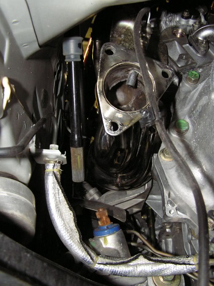

Exhaust header - steering linkage fit is tight but should not touch. Steering linkage must be able to move unrestricted.
I have seen members bang the header with a hammer to increase clearance. Seems like this solution defeats the purpose of the header.
