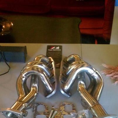

I ordered some of these TopSpeed headers and recently put them on... It was a grueling process; took my father, brother and I a total of 7 hours to do (taking turns on disassembling and reassembling bolts etc., they are hard to get to.) I was worried after seeing this thread that I would encounter the same issue . We did get everything bolted up and they did clear the steering column. I called the company too before I even started this to make sure I had received the part number for the LHD headers, thank you for that post Senofsins. So long story short, It's all bolted together no issues with clearance. Sounds a lot throaty-er and seems to climb through the rpms more smoothly. I am curious as to what the WHP is now that I have these plus: Kinetixs SSV manifold, HKS true dual replica exhaust (TopSPeed Ti burnt tips), K&N drop in; my car does definitely feel faster than the day I bought it, lol.
