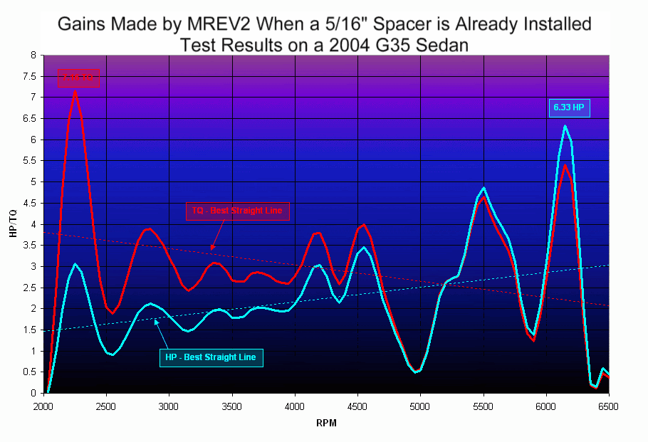

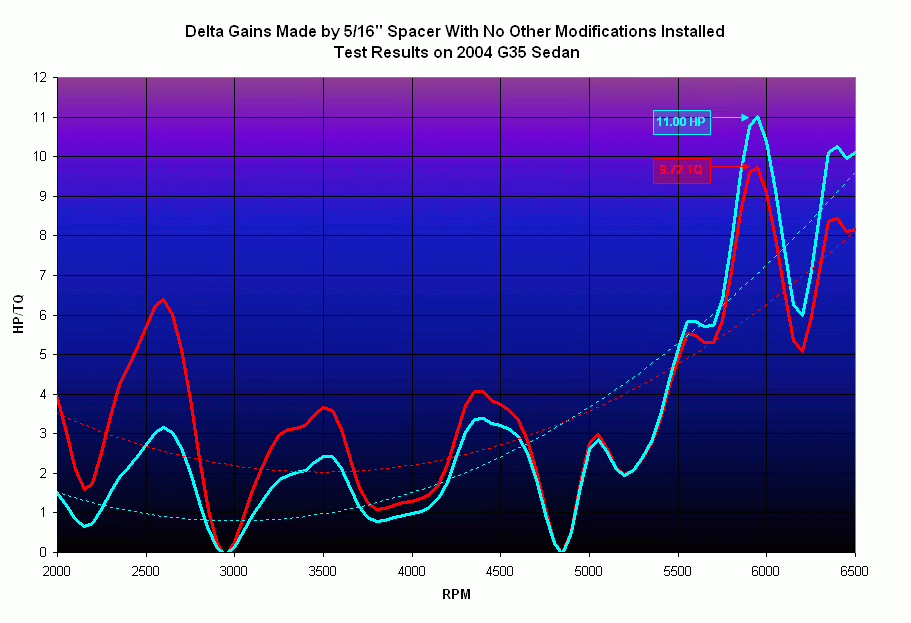

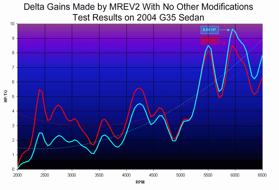

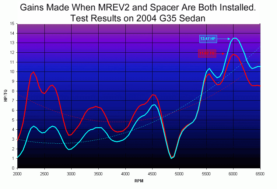

There are already dyno's for the DE showing differences between the stock, MREV2, Spacer and the combo's. Most importantly, showing deltas of each.
Spacer only
MREV2 only
Spacer and MREV2
So for us already having the spacer installed, this is the gains when adding the MREV2. Basically, it gives us a little more power and torque and solidifies the gains from the spacer throughout the range.
Can't tell you on numbers for everything, dyno's are so fickle and aren't good for showing top numbers, only delta changes for parts you add. Also, part power increases don't fully stack, they compound each other, so add together the individual gains and knock a bit off i'd say
I'd also say you can gain that back from the tune itself, how well a car gains on the tune will differ from car to car, from good to great and depending on it's state of tune and how well the mechanicals are.
Finally, and i think this is important to note, it's my favourite part, these are not all peak gains, they're throughout the range, and a lot low down, i love that. 90% of most driving, especially daily driven, will be lower/mid range, so i like getting my gains there
