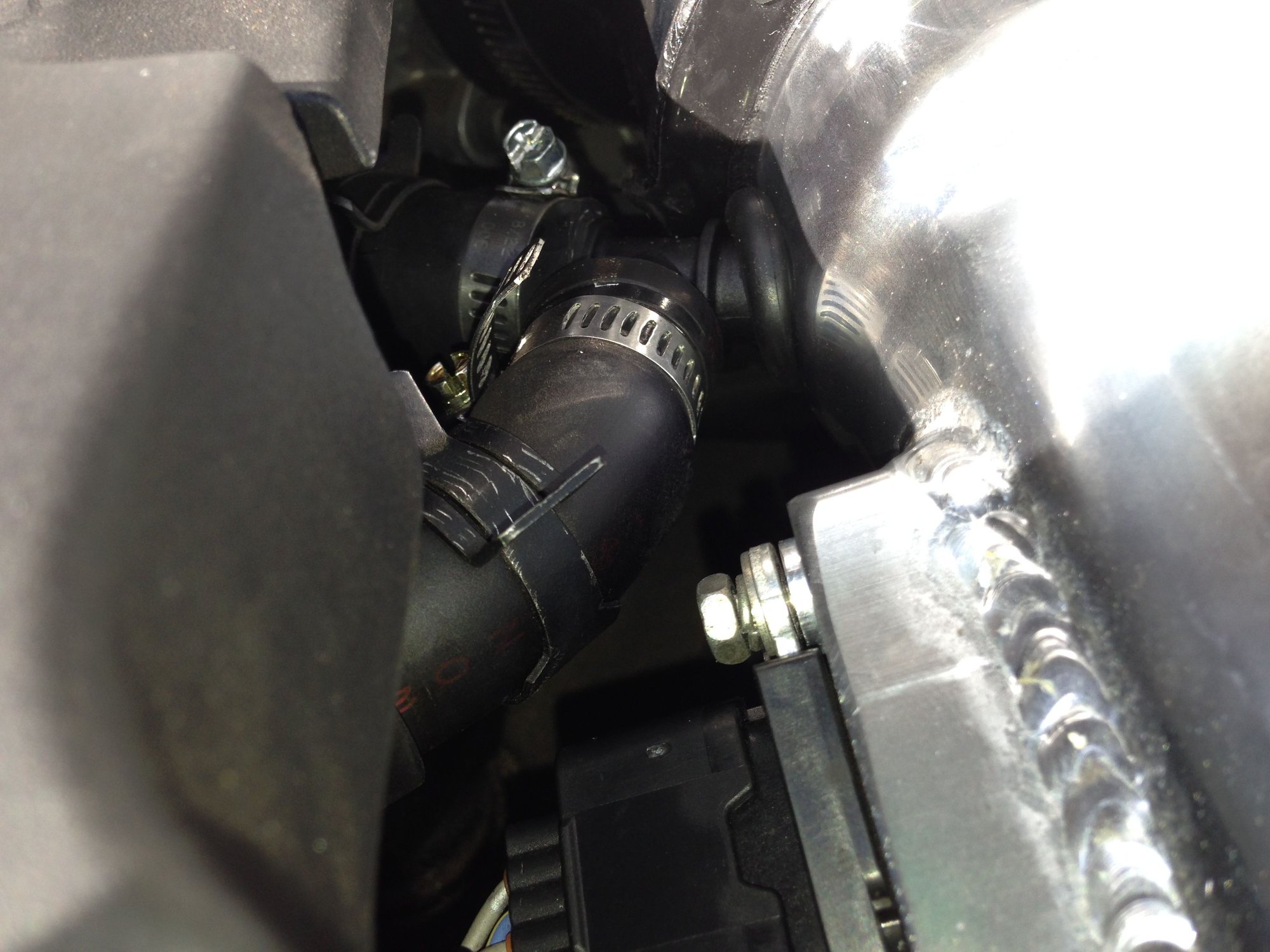

Used a 1/2" tee and the tubing supplied and to connect it all and had to get additional clamps
The bend I the heat shield I was talking about.
Problem 1. The bottom screw for the drivers side heat shield had no where to screw into. The A/C line and it's framework holding it was preventing me from getting it screwed in properly. I had to bend the bottom ear of the heat shield, where the screw would have gone, in order for the radiator screw and top screw placement to line up with the existing holes on the heat shield.
Problem 2. The breather tubes from the engine and drivers side intake weren't matching up which is what made this take so long.
Any thoughts?
