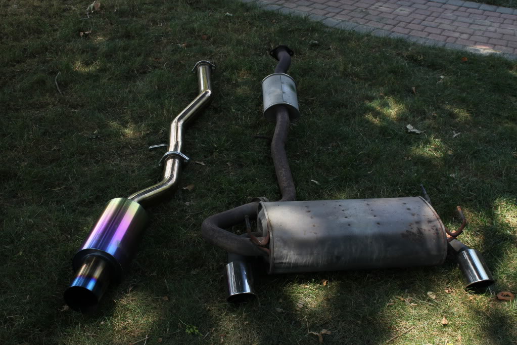

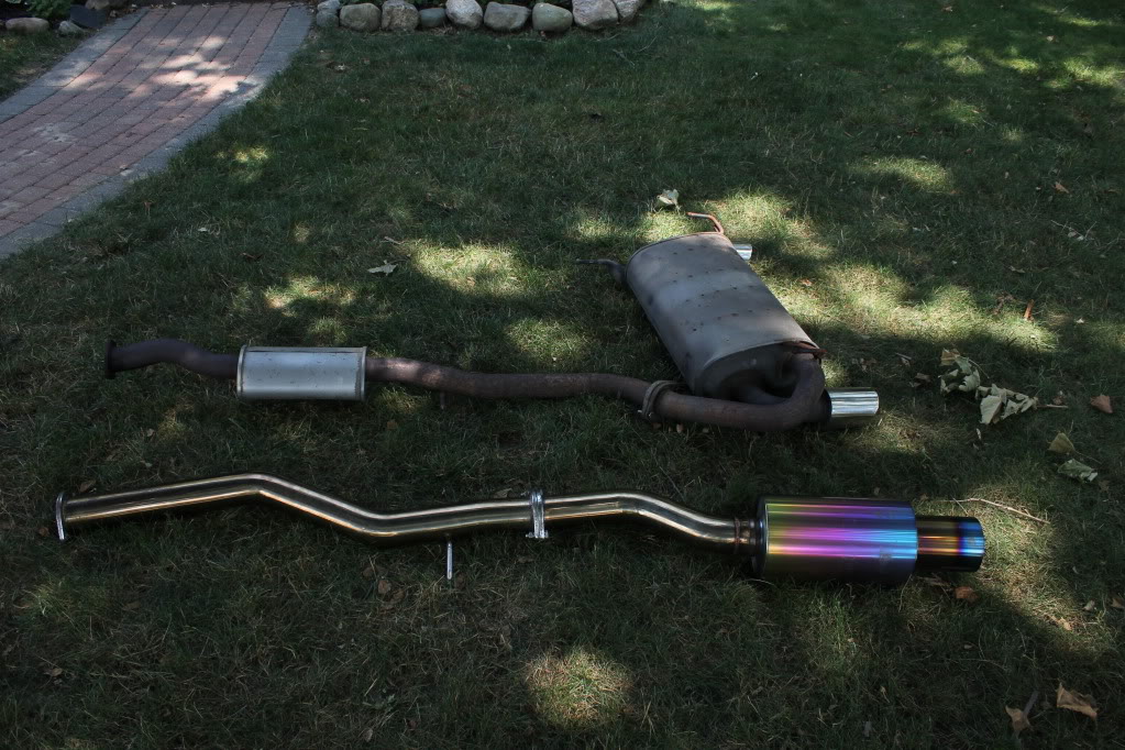

Picked this up a couple months ago. I love this exhaust, and I think it sounds great! It has a funny rasp sound when the muffler is cold, but once the muffler heats up a little, it sounds great!
Before the install...

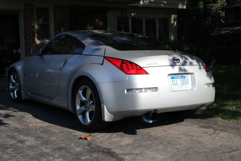

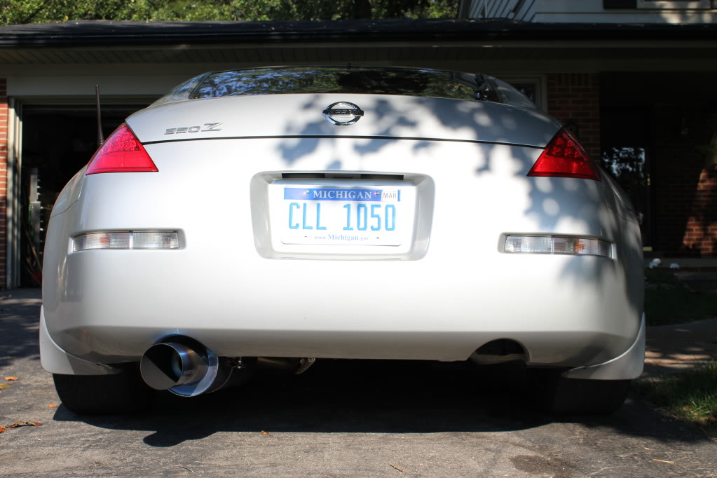

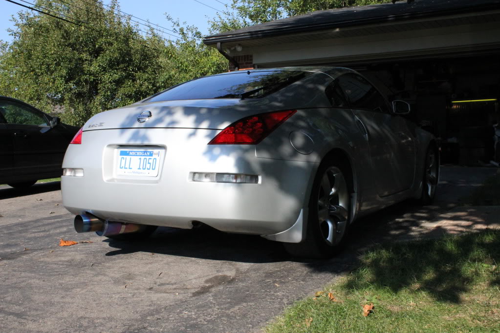

Installed onto the car (sorry, I was having trouble with the exposures due to the heavy tree shadows next to my car)...

The problems I have with it? I wish it was positioned on the exhaust cut out a little better. I got this position by modding the canister hanger a little bit, and cutting a small piece of the diff pumpkin. I also don't understand why they put the flange right next to the pumpkin, but I guess it really doesn't hurt anything once you cut that ear off the pumpkin. I am also a little upset this exhaust doesn't really work with the Top Secret/Shine knock-off rear bumper diffuser.
As for performance, just bolting it on, the car didn't really feel any faster. It actually felt a little slower, which I think is because I probably lost a little low end torque with this exhaust. It does scream in the top end, which sounds really cool. Overall, I think with supporting mods in the rest of the exhaust and a tune, it would be a great performer!
None the less, I am incredibly happy with it, and would highly recommend it to anyone who doesn't mind a louder exhaust!

I did a bumper tuck, but no pictures yet. I really like the look, and looked at a ton of pictures before I did it and really liked what I saw, but I am not sold on it (which sucks because it's already done and I already have holes in the bumper).
The other issue I have is I removed the mud guards, and my paint is all scratched around where the edge was... I tried Scratch-X and polishing it, but nothing really got it out. I think it looks kind of silly with the mud guards on. Either way, I am considering finding a stock body kit because my front bumper has a small scratch in it, my side skirts have a small crack under the front mud guards, and the rear has the mud guard issue. We will see what happens with that though...
I will try and post up pictures of the bumper tuck. My brother took his nice Digital SLR back, so I got to find my cheap point and shoot...
