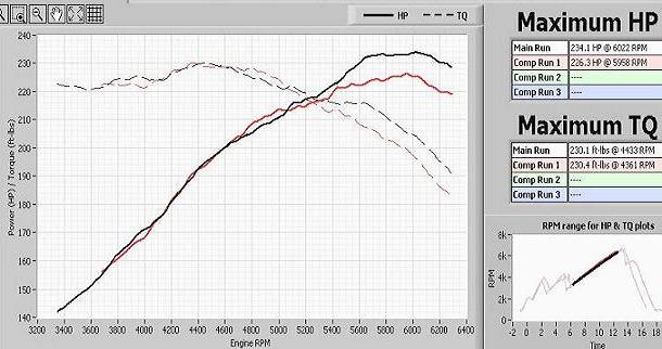

I just installed the NISMO exhaust today. I had plenty of clearance attaching it to the stock cats. It was the easiest exhaust I've ever installed.
I also have the RT cats, but am still waiting for the bolts before adding them. I made some measurements comparing them to the stock cats, and they seem like they'll make the exhaust sit a few mm lower, hence the need for the shims for the cross brace.
BTW, I really love the new sound and according to my G-Tech, 7.8 rwhp!!!
