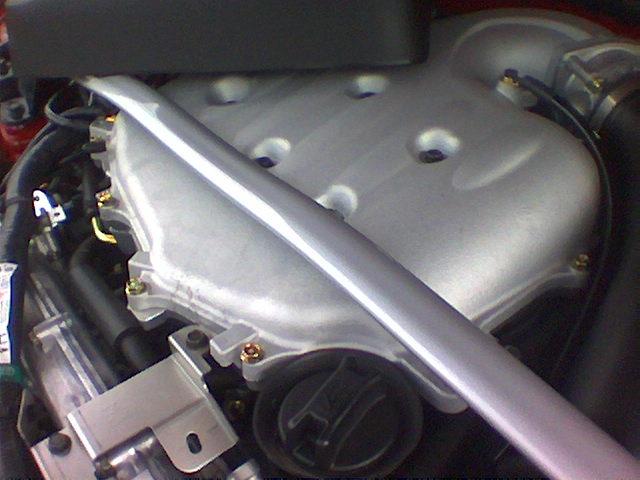

A plenum distributes air to the cylinders heads. It usually has some kind of tube or collector after the throttle, then exhaust like runners which go into the head. Varying plenum volume and runner size and shape can yield increased hp and torque.
Here's a pic of the collector area of ours. The big silver thing under the strut bar.
