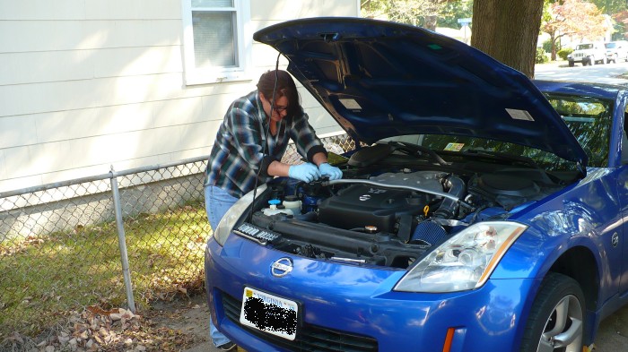

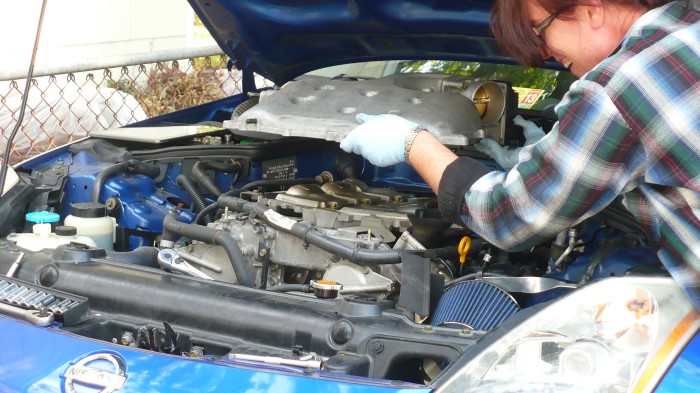

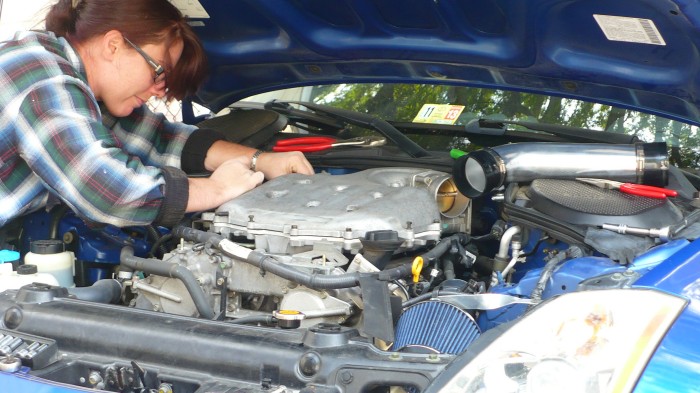

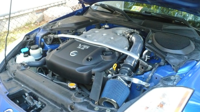

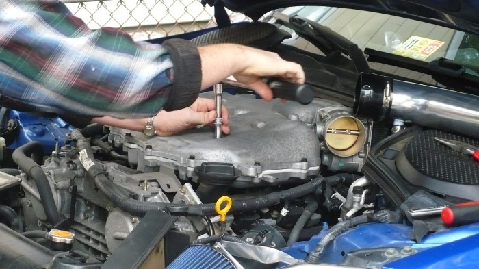

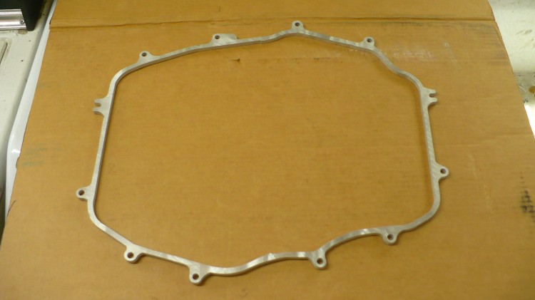

I'm mostly an information lurker on this site, but thought I'd share this for everyone. I had a buddy with a water jet that owed me so I had him cut a 5/16" spacer for the wife's 350z. Well she finally got around to installing it this morning. She's pretty happy with the upgrades and the car as a whole so far(only owned it a year). And while this is not the toughest car project she's tackled, I think it's great that she does the work and drives the car. I know plenty of guys that can't say the same thing.

How's the custom made plenum spacer though?

The spacer is fine. Just used a sheet of 5/16" 6061, made sure it was strait and smooth before and after the cut. Got two new gaskets cut from a similar material as the OE gasket. Used a little gasket tack to keep them on. And a Motordyne bolt kit holds it all down.
