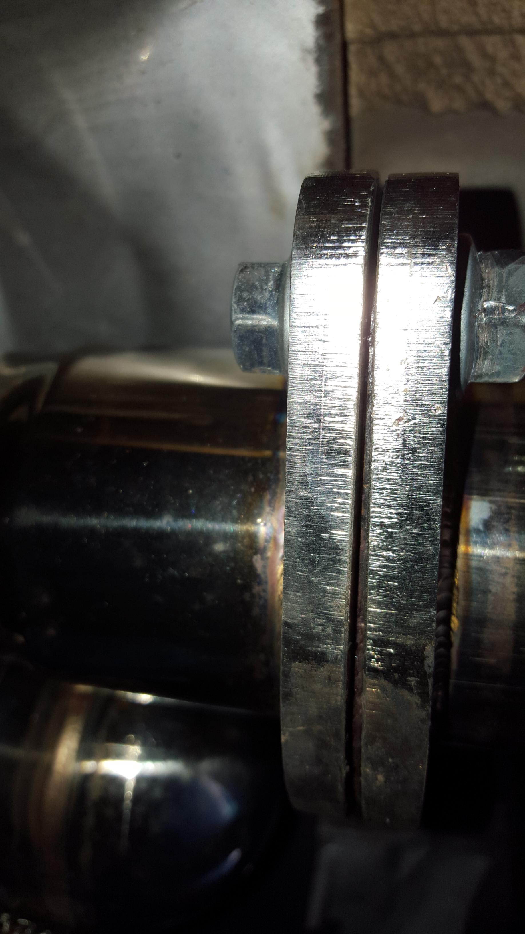

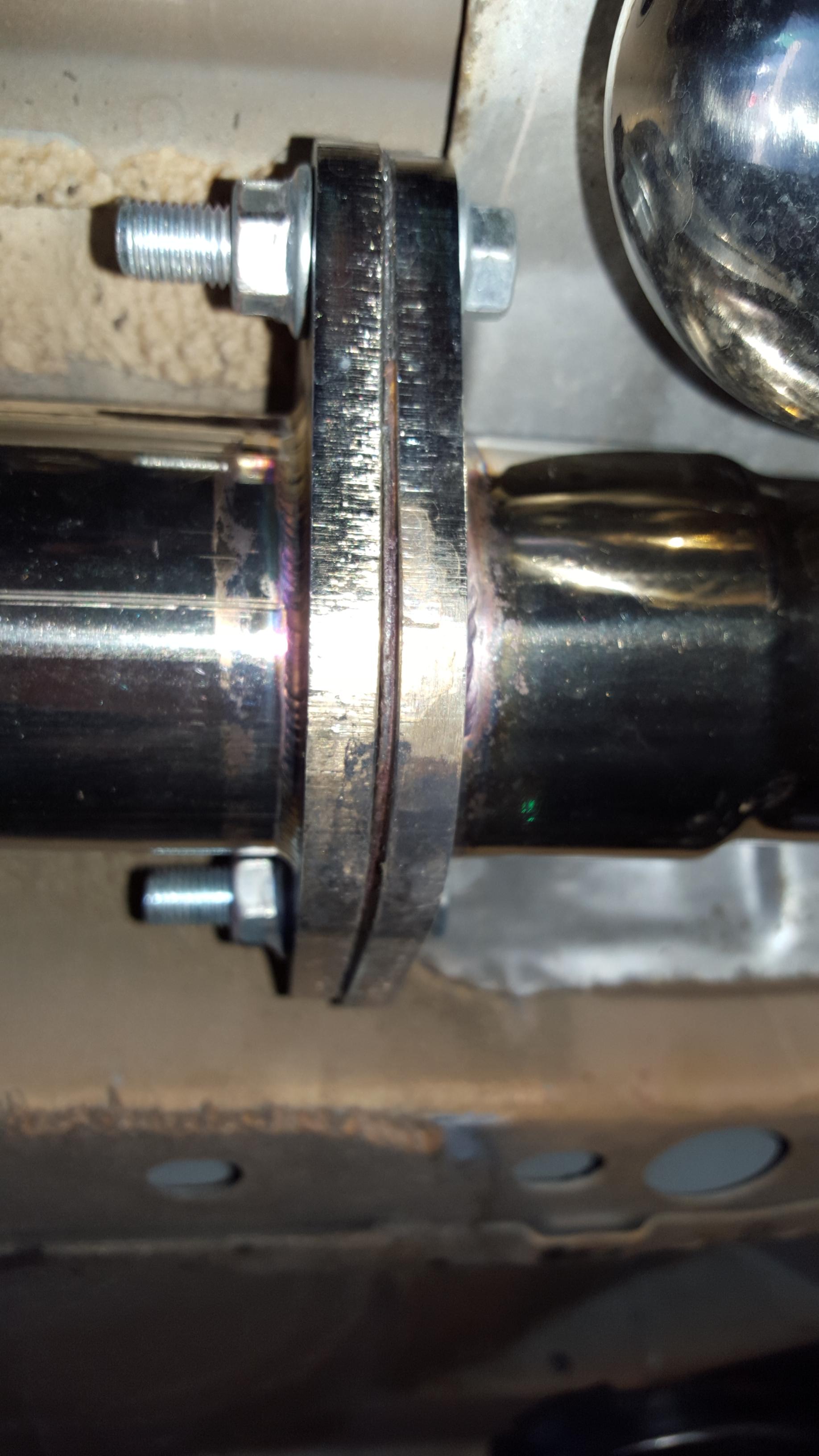

So, I just spoke with Paul at Moores Automotive, and he said don't even bother installing those flowmaster cats. He said, despite what Tony at Motordyne said, the cats down there won't do much because it only gets to be 500F after the muffler, while the test pipes get to be 1000F and thats what the cats need to work. Not only that, but after a while, the cats could get clogged up due to the residual fuel. I asked him how I can pass emissions and he countered that I had UpRev. Being the noob I am asked how this matters, and he said that UpRev is made to fool emissions work. He said that to prove this, I should go get my emissions tested, he is sure that I would pass.
To review, passing emissions and getting rid of the fuel smell are the two reasons why I started this thread. So fine, I say, wouldn't installing the cats get rid of the fuel smell? He said no, because the problem, as some of you have suggested, is due to the faulty manufacturing of the Y-Pipe/ART flanges. They are not flush even though I used the supplied, not stock, gasket. I asked if this could be user installation error (me) and he said no, this is all on MD. Pics below. He said maybe MD would work with me, but a thicker gasket would work as well. He suggested I buy a Vibrant 2.5" (1457) gasket that is significantly thicker then MDs. I ordered two, one for each side even though only one side is the problem.
Pics are attached.

I did not have a problem with the gaskets from the art pipes to the Y-pipe. It is the actual o-ring gaskets from the header to the art pipes that causes a smell in cabin. Ive replaced them with brand new OEM nissan o-ring gaskets and while it did help, there is still a exhaust leak in that location.. Its such a pain to take the art pipes off again but i will do it and install Z1 thick gaskets. Hopefully they will create a much better seal.

what i did.... i put the o ring one supplied with the art pipes, and then i trimmed the oem one to fit around the art pipes. i was being ocd
