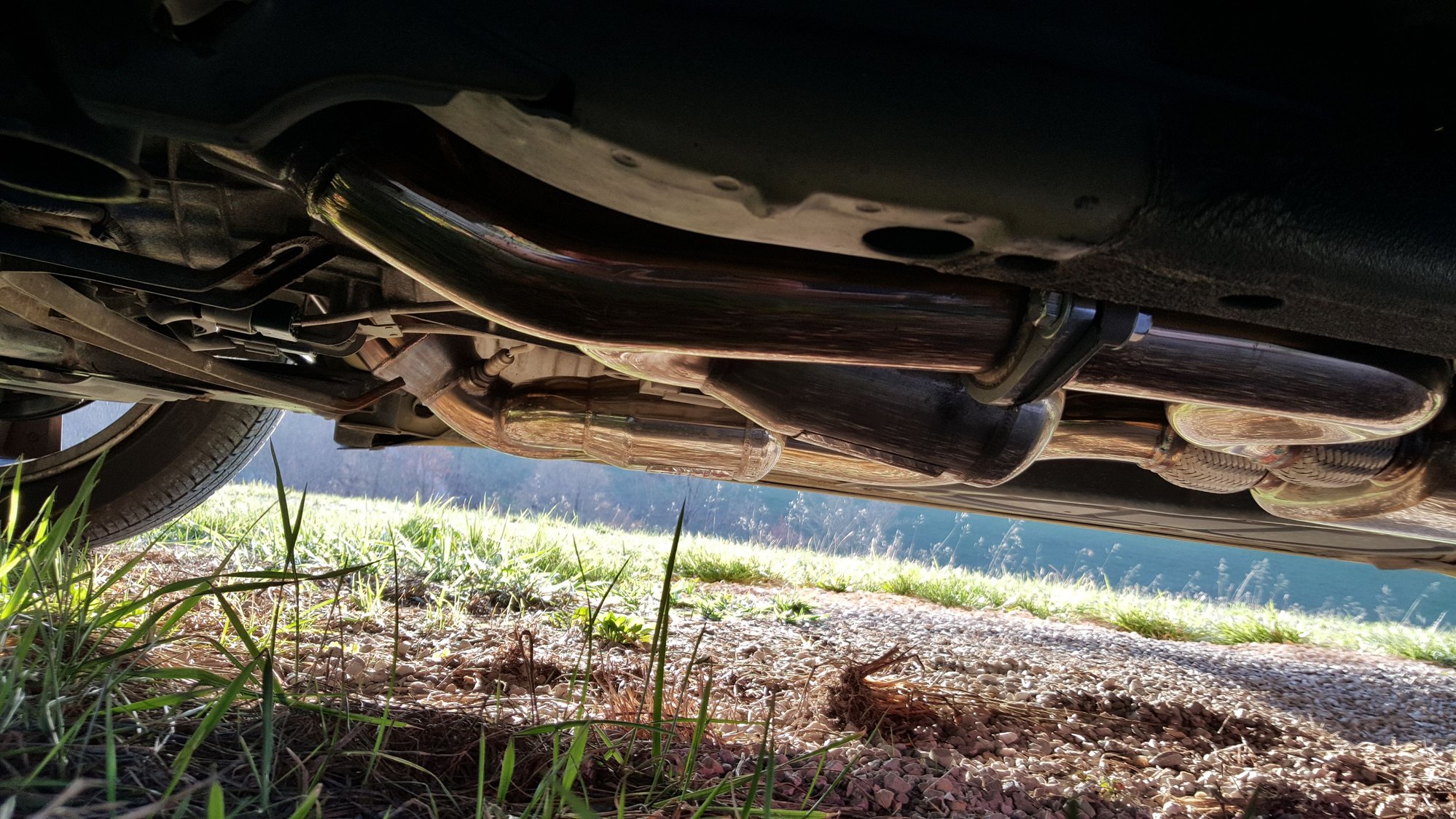

So I emailed ARK last night with these pics. Anxious to see what their reply is.

Update: So since I needed a retune due to it being initially tuned with an exhaust leak, I had the shop also tighten the exhaust. I went a bit overkill with the hardware, but it now seems to be holding just fine.
I used: flange bolts, washer, lock washer, flange nut, and lock nut.
