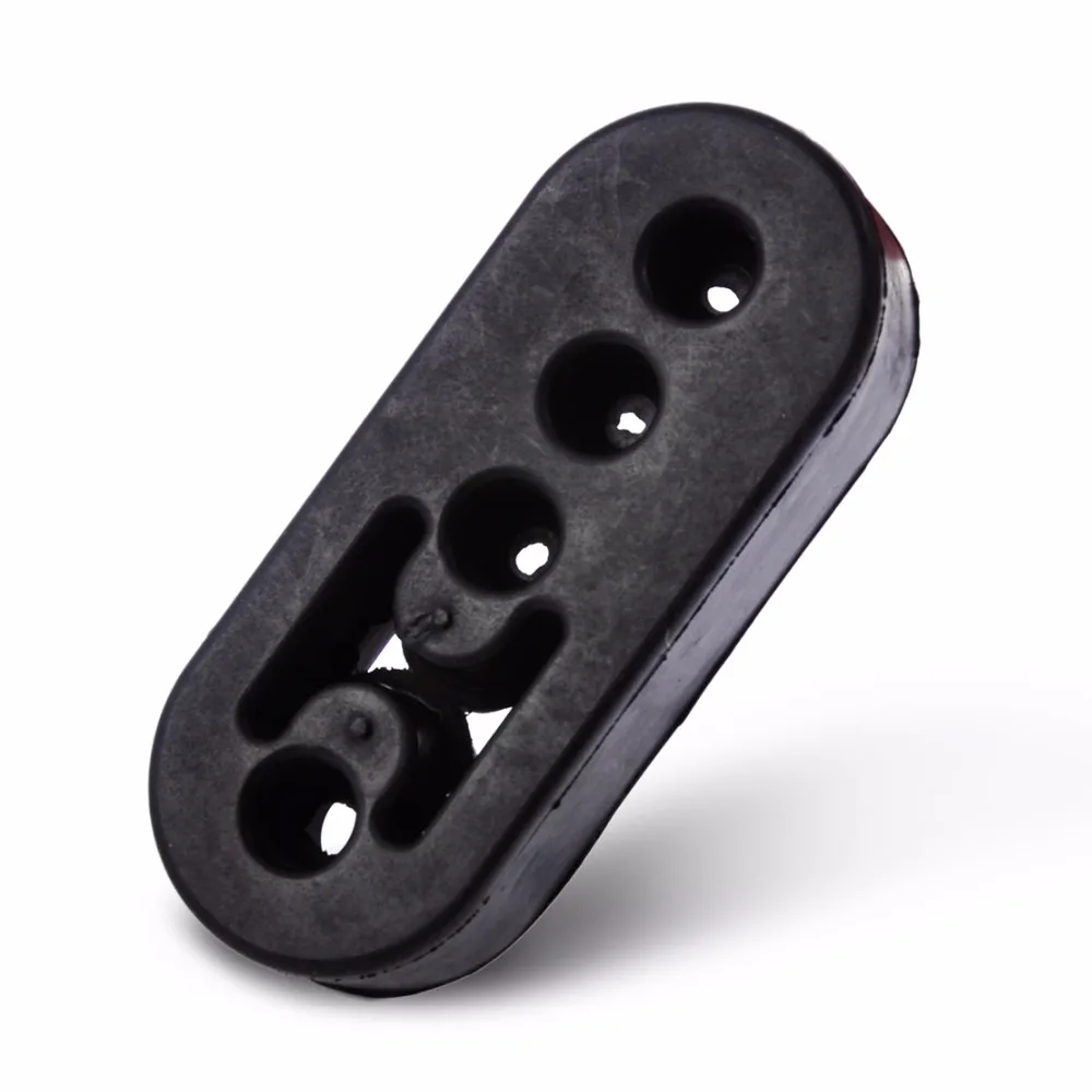

get a piece of exhaust rubber and find someway to mount it there. i had to do that with my tdx2. no matter how i adjusted it, it would always move enough to hit that
