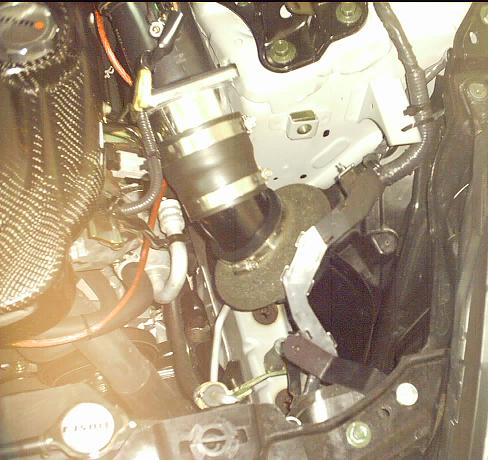

Does anyone know if it is possible to put a NISMO CAI on a roadster? I bought one and am trying to install it, but I am having some trouble with the instructions, which I guess are for the coupes. There are some differences between my car and the instructions. The part that is giving me the biggest problem is right below the AC line bracket. Below that are two studs that won't allow the CAI's lower tube to bolt to it's fastener. Just wondering if anyone else has had this problem.

I have a Nismo CAI on my 04 roadster, it will fit. I don't know if this will help you but heres mine installed.
Old Feb 21, 2004 | 12:48 PM
Dunc's Avatar
Dunc
Posts: 118
From: Southern California

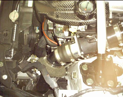

Took a couple of Pics for you, camera isnt the best but hopefully it helps
Dunc.... Thanks for the pictures... they helped me alot... I just jammed the tube down in there and I got it to stay on the rubber spacer... Scratched the hell out of the tube, but not where you can see it. I was really suprised that a new air intake could make such a difference in the sound.... it is alot louder at high revs now.

Dunc,
Don't know if you care at this point, but if you put the wiring harness mounting bracket on the upper mounting point (where the airbox was mounted, nearer to the brake fluid cover), you can get the harness completely out of the way, it looks pretty slick too.
