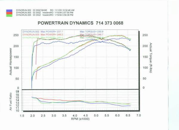

i dynoed before and after results on the nismo units...
237.7hp-249.9hp 230.9tq-249.4tq

What other mods do you have when you did that dyno?

nothing..just stock vs headers

Cool. Thanks. I want to just add headers and a y-pipe with stock muffler, cats, etc. That's good to know
