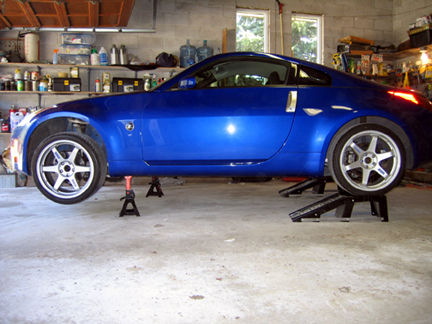

I'm really surprised that you guys are experiencing clearance problems with this exhaust. When I installed mine I had the rear wheels up on ramps and the front up on jack stands - the car was level, as though it were sitting on the ground on all fours. That gave me the proper orientation to install the exhaust with the proper clearance all around. None of the pipes are any where close to hitting each other, the crossmember or anything else. I also came from the Mustang crowd and was so surprised at how easy it was to install this exhaust on the Z compared to the couple of Mustangs I put exhausts on - there is no room for error on the Mustangs.
Bottom line - if you have pipes rubbing up against each other or on the crossmember or whatever, then I suspect you just need to adjust your installation.

I installed mine the same as Billitt13, and I don't have any problems. When I installed mine I had my friend push up on all the pipes when I was tightening the bolts, this way I would have a bit more clearence.
Hope you guys figure out whats wrong.

"When I installed mine I had my friend push up on all the pipes when I was tightening the bolts"
this is all that any of us need to do to solve the problem; but if you alone, thats not so easy. so you end up resting the pipes on the cross member while you tighten them, this causes a problem.
Old Jun 12, 2004 | 08:26 AM
Phaneom's Avatar
Phaneom
Posts: 334
From: Ontario, Canada
You can get a jack with a 2x4, rap a towel around the 2x4 so you don't scratch the pipes, and jack it up a little. Then tighten the bolts. This will also allow you to hold up both pipes making them level, and possibly make the alignment easier. (That’s if you have to install it alone.) I know its much more work but it may work.
