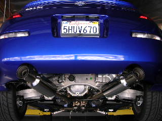

Default DC Headers
Pic3

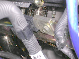

Default DC Headers
Pic4

I just read in the DC sports instruction manual that while the pipes are SS, the flanges are mild steel which will rust. WTF did I buy SS headers for if the god damn flanges will still rust!!! That really sucks especially since I live in Santa Monica where I am sure these will rust sooner than normal. I am also surprised to hear that these headers dont change the sound of the car very much. A friend of mine has a set of headers along with a full exhaust system on his 3.5 altima, and after about 5k his car fucckin screams and just sounds badass. It almost sounds like VTEC kicking in on a honda or something.

I was talking about at low RPM (2-3,000) on an Injen exhaust w/ silencer tips. However, when you floor it (3-6,500). It is definitely louder but not raspy. A very deep loud growl. If you are in my area I could have you hear them.

You would think that whoever did the instruction manual for DC Sports would have the correct information, but according to turbo high-tech magazine the flanges are stainless steel.
http://www.turbomagazine.com/tech/0409tur_zheader/
“Take a good look at the DC Sports headers and you can easily tell the runners are nearly equal length and the collector is a true three-into-one merge piece for better flow. Mandrel-bent stainless-steel tubing (1-5/8-inch) is used throughout and the flanges are CNC-machined from stainless-steel . Even the 02 bung is made from stainless steel.
With the DC Sports headers in place, the 350Z generated 248.8 hp and 239.2 lb-ft of torque. The real gains were generated in the mid-range where the VQ35DE needs it most, with a gain of 9.1 hp and 12.5 lb-ft of torque.”

This is from DC Sport’s website. http://www.dcsports.com/press_events_detail.asp?aid=41
“NEW 100% 304 Stainless steel construction (no mild steel flanges), or mild steel with ceramic coating”

The flanges are stainless. Check with a magnet, 304 stainless is non-magnetic. BTW, UPS delivered mine this morning.
