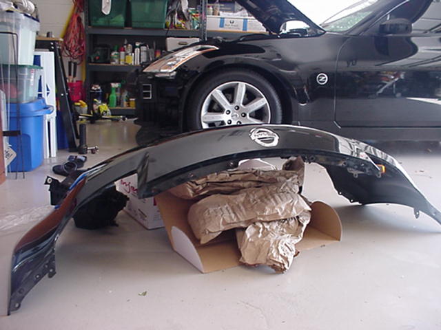

Just installed this on my fathers black roadster and it looks very clean! The filter sits in the front with clear view of the road (kinda like a ram air, almost).
For anyone else that is using this intake the problem that I came across was on the heatshield. It was actually laying against the a/c piping and I was worried about that rubbing over time and cutting into it so I had to cut the shield a bit. Here is a pic of that: http://www.wrxturbo.com/Product%20Pi...heatshield.JPG
For those that have this intake installed with the heatshield then you should check to see if the sharp edges have cut into the a/c pipe.
I've got some good pics here of the intake and install:
http://www.wrxturbo.com/Product%20Pi...k%20intake.JPG
http://www.wrxturbo.com/Product%20Pi...%20intake2.JPG
http://www.wrxturbo.com/Product%20Pi...bumper%202.JPG
http://www.wrxturbo.com/Product%20Pi...r%20filter.JPG
http://www.wrxturbo.com/Product%20Pi...mper%20off.JPG

One more that wouldn't link for some reason:
