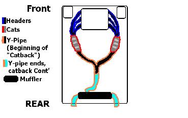

Exhaust Lesson #1.....I'll continue the Lesson shortly..RECESS
Attached Thumbnails Can someone explain the parts of an exhaust system?-exhaust-lesson.jpg

Lesson #2......
-The most restrictive parts of the Exhaust Are: The Y-Pipe, and the Cats. The Z has FOUR Cats (Stock) which you could replace with TWO High flow cats, OR Resonated Test pipes. I dont think the Test pipes are for you, however, because they get quite loud, and your chances of passing emissions diminish. Replacing the Y-Pipe alone will show some gains and improve the sound ALITTLE, but not much. The Cats are the MAIN bottleneck in the system, I recommend some nice High Flow cats: Kinetix or Crawford.
Next! You say youd like to make it alittle louder...I recommend going to a TRUE DUAL (refer to picture) Exhaust system, Like Injen or Borla. Borla is Louder than stock, Injen is Much louder than Borla, Search around for sound clips. Borla will give you a V8 type exhaust tone, but subtle.
-SO. Based on what you want: Louder/Deeper/more aggressive, I think a Borla TD+ HF cats would be a good combo for you. I love them. End of Lesson.

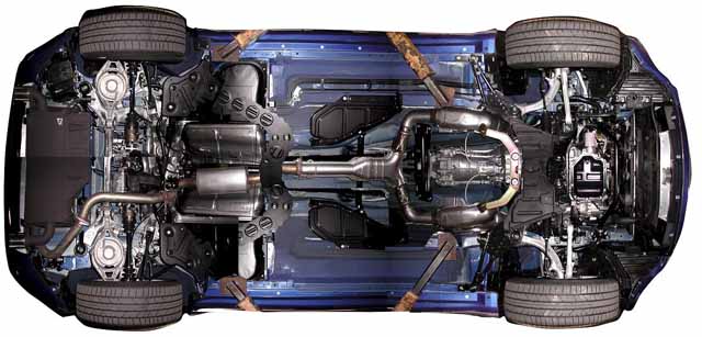

A TRUE DUAL System Resembles This.............
Attached Thumbnails Can someone explain the parts of an exhaust system?-exhaust-lesson-2.jpg

I think I finally understand why a True Dual does not have dual mufflers pieces. Always wondered about that.

Zbottom
Attached Thumbnails Can someone explain the parts of an exhaust system?-zbottom.jpg
