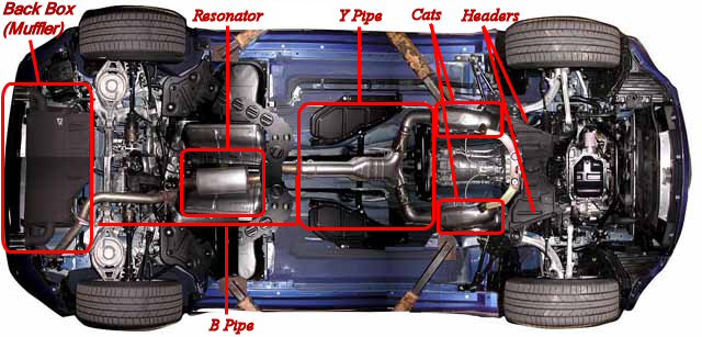

Manifold > Cats > Y Pipe > B Pipe > Back box
The pipe with the resonator (triangular shaped muffler in the middle of the car is also called the "B" pipe.

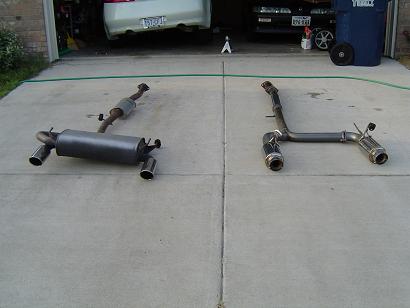

With topspeed, RSR, Invidia u will be replacing the setup in the pic. Here is the link to the exhaust video: https://my350z.com/forum/showthread....light=topspeed

Is that the resonator removed in the pic on the right? Or is that a cat? Sorry for the newb question, but what does the resonator do?

If I may borrow the picture from earlier. This might help some.
Other than Quieting the exhaust tone, it does absolutely nothing.

Any way a diagram can be overlaid on that?
EDIT: Never mind, Chris got to it. Thanks, Chris!
