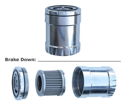

Has anyone used this one before? I know very expensive, if it last 23 oil changes then that's like buying a regular filter at 6 bucks 23 times.
http://www.hopupracing.com/troilfiing35.html
TRUFILTER, lifetime direct replacement washable oil filter, designed from 6061 T6 billet aluminum, this housing has a 1500 lb crush rate. The washable filter is a deep pleated, duplex woven, 35 micron surgical T304 stainless steel filter for superior washablity. A self sufficient, environmentally friendly oil filter. That not only creates more horsepower, but extends oil change intervals from 3000 to 7000 miles. With all of todays aftermarket performance parts, Consumers should not forget about the most vital part of the engine, “the oil filter”. This is the lifeline of your engine. Adding performance parts to your vehicles engine creates more pressure in the oil filter, this causing your oil filter to swell and compress, damaging oil seals and putting large stress figures on your oil pump. Average HP gains are 5-6. Also with the engine running more efficient, you should see an average of 1-2 mpg. TRUFILTER, filters your oil an absolute 35 micron with one pass, utilizing our “quad flow technology”. With an average install time of 5-10 minutes this kit comes complete with everything you need to do the install. All filters carry a complete lifetime warranty and are good forever. This Filter is also transferable to any vehicle by changing the main insert. This insert is free of charge from the manufacture. TRUFILTER is truly the last oil filter you will ever buy!
TRUFILTERs revolutionary design is made with T304 stainless steel media therefore allowing it to be reusable and cleanable. Unlike paper filters, the Billet aluminum exterior gives a polished appearance to your motor. Most paper filters only filter an average of 50-75 micron particles. TRUFILTER will stop anything to an absolute 35 micron. Remember, white blood cells are 25 micron. Paper filters have a “Bypass” that opens at 12 lbs of pressure. Most motors idle at 11lbs of pressure. At 12 lbs, the bypass opens and filtering stops. All of the dirt and metals are then sent back into your motor. Paper filters only filter 10-20% of their actual life. With TRUFILTER, oil changes can be extended to every 7,000 miles. This will save you time, energy and, most importantly, money.
That TRUEFILTER info is garbage.
Firstly, you won't get a 5-6HP boost simply by changing your oil filter. That claim has no basis in reality; complete hogwash.
Secondly, a 12psi bypass valve opens when the pressure drop ACROSS THE FILTER ELEMENT exceeds 12psi, not when the absoute oil pressure is 12 psi. The bypass valve only opens if the filter is extremely clogged, or at startup when there is a surge in pressure. It is a protective feature that prevents your engine from being starved of oil in abnormal conditions. All good filters should have a bypass valve.
Secondly, 35 micron particles are quite large by oil contaminant standards. Good synthetic media filters (Mobil1, Purolator Pure One etc) have filtering efficiencies of 95%+ for particles in the 10-20 micron range.
