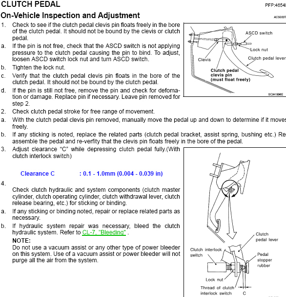

I just had my tranny and clutch replaced the other day. The new clutch takes up about 2 inches later than the previous one, way too late in my opinion. Is this adjustable? Dealer says it is not. Want the feel of my old clutch back Can anyone help.

I really don't have alot of options. I could drive an hour and a half to louisville, and possibly still get crappy service. Bottom line is they f'd it up they must fix it. I hope things don't get to messy if you know what I mean. I will not be going back to them for any future warranty claims. Will try adjusting the pedal myself when I get the car back, if they can't figure it out. Thanks again for the tech info.

It has been awhile and I tried to get used to the way the new clutch felt. Still didn't like it, so I tried the clevis adjustment at the pedal 1 full turn in. Then readjusted the ASCD switch so that the clevis pin floats freely when the pedal is released. Over all pedal travel is a little shorter but dosen't seem to affect shifting and, clutch feels much better, like it did before the cluch replacement. P.S. The service department fixed all of the things they messed up and left off after showed the sevice manager the damage and gave him a list of things they messed up. Thanks again westpak
