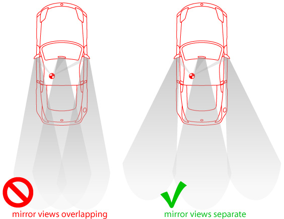

for mirror placement, I saw this posted on another site. to maximize your rear viewing angle, put the inside edge view of your side mirrors at the viewing edge of your rear view mirror. it works quite well. no one ever told me other wise, and consequently i always adjusted my mirrors incorrectly. i made a little diagram to illustrate.

You have no idea how much you just helped me.
I did what that diagram said and now everything is much better.
Please tell me it wasn't in the owners manual because that would mean that I managed to miss it.
Anyway, I now have my side mirrors set as you described and it works like a champ. I left just a bit of overlap on the left side, but now I can follow an approaching car in the right lane as it transitions from the rear view mirror to the side mirror and now no blind spot!
Awesome. It still took some getting used to simply because i had to move the mirrors "out" so much. I'm used to leaving just a glimpse of the rear quarters in the field of view for reference. Now the mirrors are way out there, but I have no more blind spot.

I owe you one, Koryo...

nice to hear that it helped. i tried it, and ended up profusely thanking the guy that posted it. it's what i needed too. it's not in the manual or anywhere else that i have noticed. it might have been in drivers ed but that was a long time ago and i probably missed that question anyway.
it is strange at first. i mean, you have to physically turn your head and site different mirrors to look behind you. but the part i like most is what it does for night driving. the lights of a car that is directly behind you do not show up in your side mirrors. much less annoying. esp. if you have an auto dimming rear view mirror.

Put your head against your driver window.. then adjust the left mirror so it jus sees the side of the car.
Then lean towards the middle of the car, and adjust the right hand mirror so it just sees the edge of the car.
Using this setup.. I can see the sides of the car great.. and I've learned if I can only see half their grille, that is the break point for passing/moving over. At that point is kinda cutting them off.. but I fit
Seeing the entire front of the car in the mirror is a safer pass.I can't see out the C pillar windows at all where I sit, but the mirrors and glances over left shoulder give me all the confidence I need.
