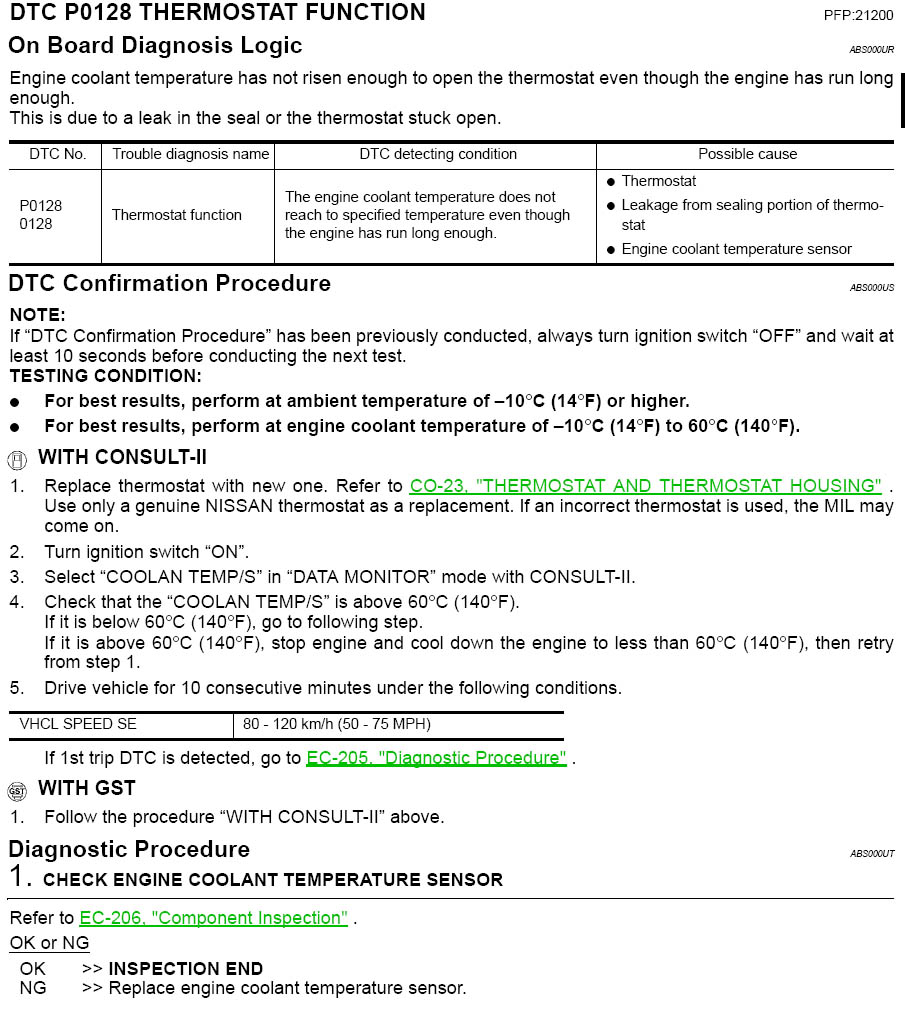

I don't know if the Greddy EU caused this malfunction, but I got the P0128 trouble code / SES / CEL
which basically states that the engine coolant temp does not reach the thermostat temperature even though the engine has been running for sufficient time.
Any suggestions?
I will probably take out the EU and bring it in to the dealer.
I doubt the EU could have caused this condition but who knows?
I reset the code twice using the "technosquare pedal method" and the code came back twice.
Attached Thumbnails P0128 Thermostat Function with Greddy Emanage Ultimate-thermostat.jpg
