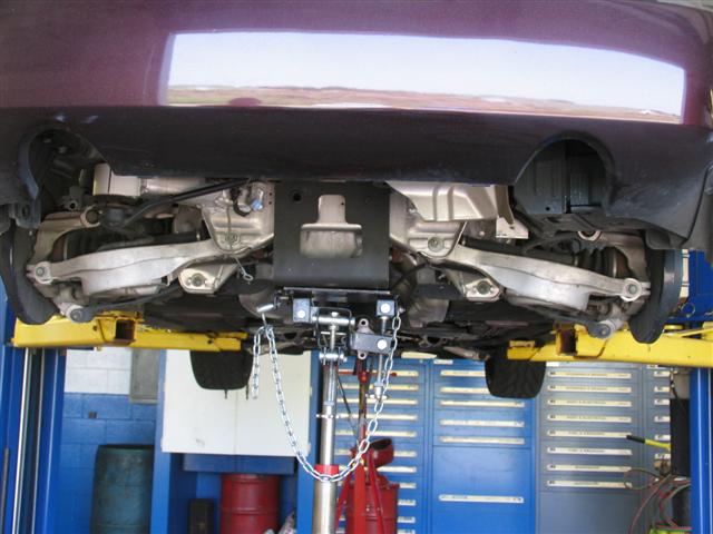

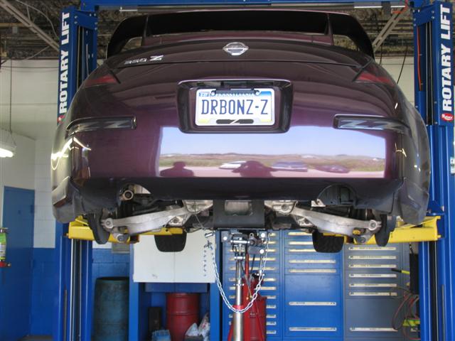

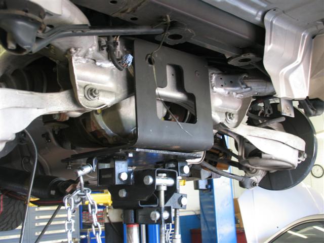

Here are some pics I took that day:
Attached Thumbnails Fuel Filler Tube Recall Work Done-img_6037-small-.jpg   Fuel Filler Tube Recall Work Done-img_6038-small-.jpg   Fuel Filler Tube Recall Work Done-img_6039-small-.jpg   Fuel Filler Tube Recall Work Done-img_6040-small-.jpg

Those pics were taken just before he dropped the rear suspension and just after he took off my entire exhaust.

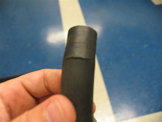

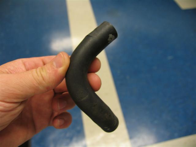

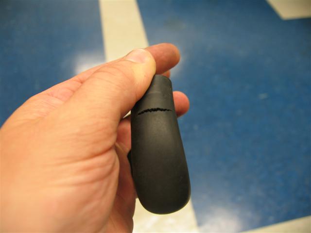

Here are pics of the rubber hoses that were replaced.
Attached Thumbnails Fuel Filler Tube Recall Work Done-img_6041-small-.jpg   Fuel Filler Tube Recall Work Done-img_6045-small-.jpg   Fuel Filler Tube Recall Work Done-img_6046-small-.jpg   Fuel Filler Tube Recall Work Done-img_6047-small-.jpg
Old Aug 14, 2006 | 05:36 PM
Dr Bonz's Avatar
Dr Bonz
Charter Member #19
Posts: 6,490
From: Zainoland
The larger of the hoses (the first pic) is the fuel filler hose. Mine had no cracks but the tech said that the clamp that held it onto the tank was a bit loose and could have been the cause of my leaking.
The smaller hose is one of the evap hoses. As you can see, it had cracked. No actual fuel runs through this one, but he told me that this crack could have been the cause of the strong smell of fuel I have in my garage all the time.
