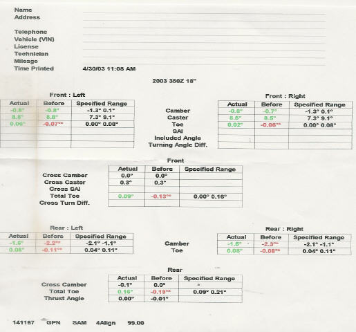

This ain't take 20 mins but U may not be able to read it....
It is my Alignment Printout. Mine was horribly out. I think this says I get new tires. I will even pay a prorated figure, to 7000 miles, when I first reported the issue.
I will let you know what happens.

Well Cool!
Because my rear camber and toe were so whacked from the Factory and the front toe was out too, and my tires were justa total mess, I am getting 4 new tires!
Very happy about this outcome. Will see if tires cup again.
