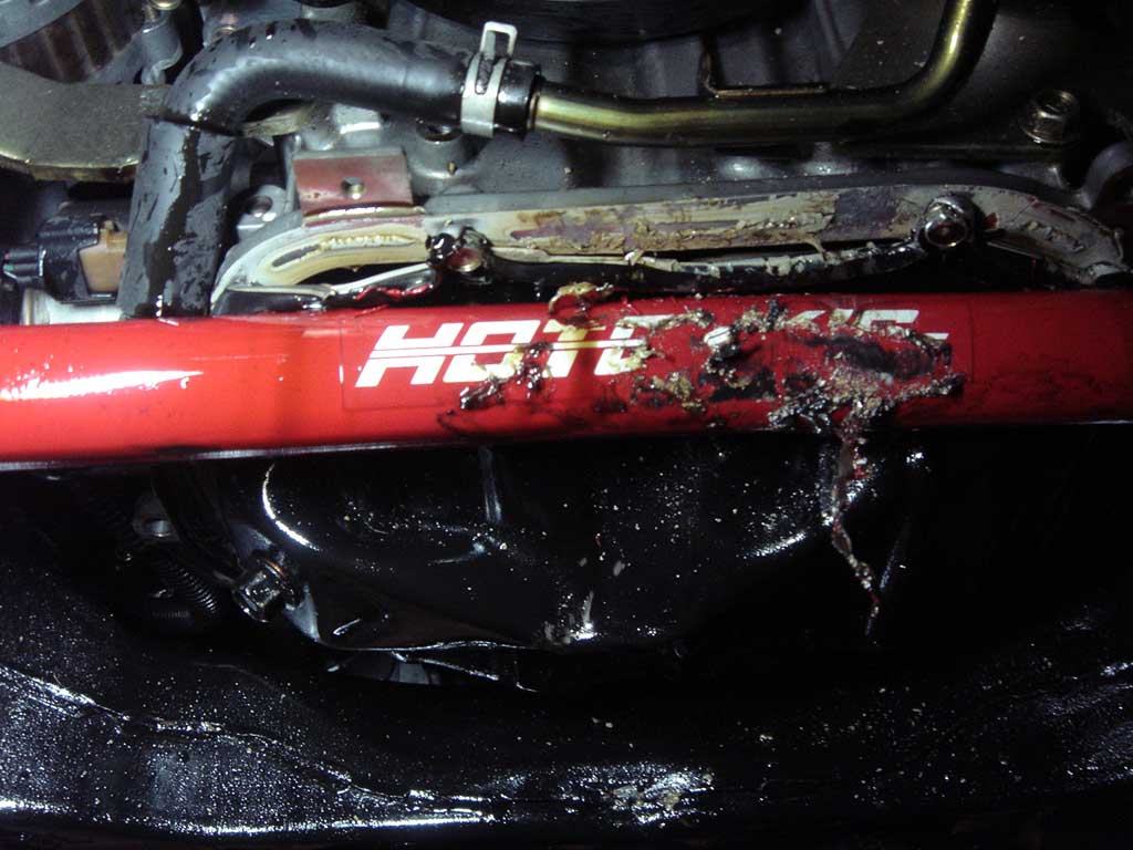

I never thought I'd be typing a posting like this, but... I was driving down 2222 at about 10:30pm, and as I came around a turn there was a rock in my lane. I had plenty of room to swerve and dodge it, or brake, but I didn't think it was a rock, and I wasn't 100% sure there wasn't a car in my blind spot, so I just went right over it. It hit hard, so I pulled over and immediately saw that oil was coming out of the engine, so I shut it down within 30 seconds (and I noticed the oil guage still read about 45 psi). I figured I had cracked the oil pan, no big deal.
So I had it towed to UpRev, since my friend Jared was still there installing the new dyno, we put it on the lift, and it turns out the rock bent the swaybar back, crumpled up the oil pan, and the engine block has 2 or 3 cracks in it. I'll try to get some photos posted tomorrow.
It's a 2003 350Z, the engine had 57000 miles on it. I guess I will plan to buy a VQ35DE (non revup) engine, and think about whether to claim this on my insurance. What does a new VQ35DE cost, and labor to install it? I know I could probably replace it with a revup version, (although that also requires a different ECU), but the revups have this oil consumption problem, and I just want a reliable engine. The VQ35HR is tempting too, but same deal, plus I'm not even sure it would fit, any I don't want to be the first one to try it.

Here's a pic that paints a good picture...

wow that rock did some damage.....

Holy crap that's some serious damage...
I believe used VQ35DE from Z cost around 3K depending on the condition and milage.

wow must have been a huge rock, im getting kind of scared now since i dont have an under carriage, cuz it ripped off

I did have an undercarriage, but it's plastic.. it didn't help at all.
I'm pretty sure the rock was limestone, it's the most common rock around here, and the rock actually split into about 10 pieces when I hit it. I went and moved them out of the road while I was waiting for the wrecker. I guess the good thing is, the rock split up, so my whole car didn't roll over it... it could have caused damage all the way down the center of the car (diff, cats, exhaust) if it hadn't broken up.

A new motor can be had for 5600.00, a block is 1500.00, a short block is 3000.00.
But keep in mind that there is a lower oil pan -60.00 and an upper oil pan (aluminum) thats around 90.00, It may be your upper pan that is cracked.
On the other hand, its about time to freshin up the internals while u have the down time

And ya, Get HOT soapy water and a brush and scrub those tires immediatly
