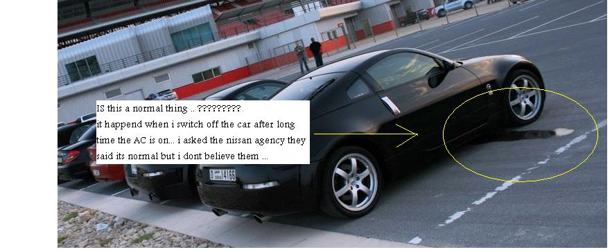

hi there guys.. i dotn knwo if am facing a problem or this is normal.. please help .. check the attached pics for the info...
thanks

it is normal, high humidity where you are.

yeah its too much humed but i looks like the Z is pissing in her panties... hahhaha .. my buddy z didnt **** that much as mine...

It is very normal as said with Hi Humidity locations. As a matter of fact, it is showing that your condenser drain is free from all the crap that accumulates within the fins and the enclosure. < good thing !!!! An A/C unit is in essence, also a dehumidifier, the higher the humidity, the more water from air is removed, hence----Draining from your unit

touch it, smell it, if it's just water you know it's ok.

And if he is running his at the same setting, then he needs to find out 1.) Is his drain becomeing plugged ? 2.) Is his A/C unit running top efficiency
