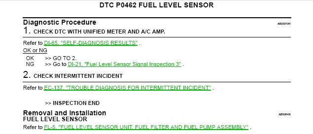

Does anyone know how to fix a P0462 code?

Here's what the service manual says about P0462.
Attached Thumbnails Service engine soon light?-p0462-1.jpg   Service engine soon light?-p0462-2.jpg
