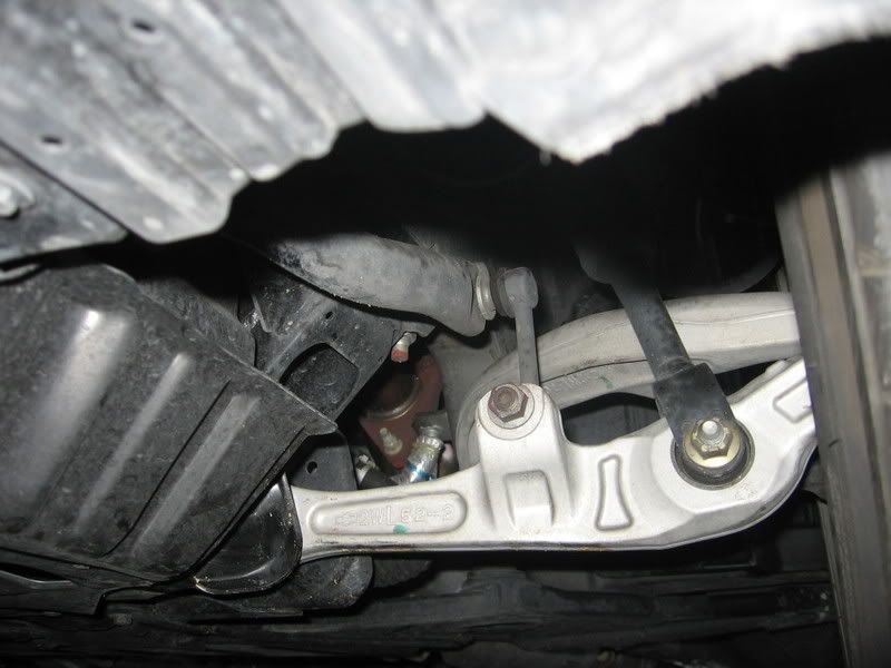

Insurance an no Z car for a week and it'll be fine. A coworker let a guy who claimed to be a detailer (on a bike no less) wash his car because he needed the money and his hood got ruined because they guy used a dirty brush. It could be worse, at least my paint didn't get hit at all.
edit - the pics show rust in the tear by the bolt, and the rust colored stuff in the very bottom corner is just wood from the log.

From the looks of it your lower control arm bushing is shot anyway. Recommend taking it to a dealer or bodyshop. Having them replace the control arm and when it is out, have them bend that tab.

The metal on that tab is cracked, I'm going to try to get a whole new members. And the car has 9,000 miles, if that bushing is shot thats sad....REALLY sad. I need to get a better look at the control arm but I think it might actually be ok.
I can see what you mean about the bushing.(yellow arrow) The bushing looks dry rotted with that crack. OP, you'll have to have the entire lower control arm replaced. They don't sell the bushings separate. The bushings are pressed into the control arm and come as one piece.
I don't know if thay tab can be bent back though.(red arrow) Mine is bent also, although not as bad. I'd say to leave it as is, as long as it isn't effecting the alignmentment or movement of the control arm. But the problem is, the bend looks bad enough to prevent movement of the control arm. The tab is thick and extremely hard to bend. Believe me I tried with a large hammer and Vice Grips.

The bushing is cracked and also the control arm has shifted forward. We typically see this if tow companies tow from the arms. However impact on that arm from the front or rear can shift that arm and therefor needing replacing.
I don't mean to question your expertice on the subject, but how can you tell the control arm has shifted foward? It the impact of the log was on the front side of the control arm, wouldn't it have shifter to the rear, if it did?
On the other hand, shifting foward due to a tow truck wench pulling on the control arm makes sense..

To be perfectly honest I hope that is the case because I do think the arm is probably stressed in some way, its just convincing my insurance company to cover it. Shouldn't be too hard, but its still bothersome, I'm not going to be able to get it to the dealer until Friday, my schedule is just too busy this week and its a 2 hour tow (the dealer in town really is that bad).
I thought I saw the same crack on the other side and it looked like a "molding" cut to allow some flex and control where the bushing cracked down the road (I assumed). I guess I'm wrong, thanks for pointing that out and I'll definitely ask the tech about it.
I was too distracted by noticing the crack in the actual subframe member to pay attention to whether the control arm really was centered, but it didn't look shifted when standing under it.

It's possible it's just from the angle of the pic. It appears that the gap between the back side of the control arm and the subframe is excessive. Again, it's tough to say for sure by looking at a pic. Just want to give the OP something to look at to be safe.

Also in the pic you can see where the bushing had been sitting. There are wear marks on the bolt shaft. Just trying to help.
